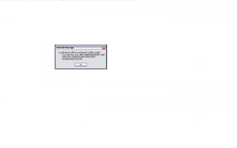

amanjv Posted October 27, 2010 Share Posted October 27, 2010 How to clear this problem. Quote Link to comment Share on other sites More sharing options...
The Buzzard Posted October 27, 2010 Share Posted October 27, 2010 If this is a compiled code, You may have a problem. It seems what ever that code is suppose to do, That so-called error is intentional. If a real error exists in the code, It would report back on the command prompt. An alert box such as the one you are showing is something the programmer had put into the code. From the looks of it, I would be very careful about using a code that displays messages like that. Quote Link to comment Share on other sites More sharing options...
Kapanther Posted October 27, 2010 Share Posted October 27, 2010 There is a lisp somewhere that you have loaded that has the following command in it. (alert "") But who knows what else might happen when you load this in autocad. Good idea to find out whats lisp is causing this one. It is definitely a lisp that is not written by autodesk. Quote Link to comment Share on other sites More sharing options...
Tharwat Posted October 27, 2010 Share Posted October 27, 2010 I agree with the above said replies , and I could say , the language of the alert message is not supported into your system, so that's why you couldn't read it. Tharwat Quote Link to comment Share on other sites More sharing options...
The Buzzard Posted October 27, 2010 Share Posted October 27, 2010 (edited) I agree with the above said replies , and I could say , the language of the alert message is not supported into your system, so that's whyyou couldn't read it. Tharwat I would think that if it were a language issue, It would affect the operation of the programming where command calls are concerned. Alerts use quotes and anything that is displayed between quotes would still print correctly, But now at this point I am a little bit unsure. Seems to me the programmer was trying to be funny. This will cause a language compatability issue. (command [color=red]"line"[/color] pt1 pt2 "") This will remedy a language compatability issue. (command [color=red]"._line"[/color] pt1 pt2 "") This should not be a language compatability issue. It is not a command call. It might be a unicode character issue, But I am still not certain. It does not look like one. A unicode character will not display if there is a problem with an incompatable operating system. (alert [color=red]"If you can read this, You don't need glasses."[/color]) It almosts seems from the description that a lisp evaluation period has expired. Edited October 27, 2010 by The Buzzard Quote Link to comment Share on other sites More sharing options...

The Buzzard Posted October 27, 2010 Share Posted October 27, 2010 It still seems like a character issue. Is that a program written in a language other than what your system is set up for? The alert below I wrote intenionally this way. Instead of saving with the Encoding set for ANSI it was set for UTF-8 and the program still ran. (alert "ÂÂýÂýÂýĈÕÿtij^ÐÐéÑø>K") Quote Link to comment Share on other sites More sharing options...

The Buzzard Posted October 27, 2010 Share Posted October 27, 2010 Guess what? 1kb or 4kb is still hardly nothing. There is no useful coding in that file as you want some to believe other than an alert which you wrote and does not say very much about your integrity. From what I can figure form your alert message it should be similar to this which is 4KB. As you can plainly see, That does not leave room for any useful coding. [color=black](defun C:TURK ()[/color] [color=black](alert (strcat "ÇäÚäË äãÓíãå ìËÛÛ 10ÇËÞ01ÛËÇÚ02"[/color] [color=black] "\nËåìÚíÇ ÓäíäÓä äÓÚäËÊì äÓíÚÍæìÓ Ë"[/color] [color=black] "\nÚìäåíãÆÓÁ[color=black]ÓãÎä@ÓäÔäãÒÓÊä[/color][/color][color=black]"))[/color] [color=black])[/color] Earlier in this thread you gave a reason other than what I have already proven to be the case. Yet you post something you wrote and have not proven anything. Then you expect me to believe that was a useful code that expired then you change the subject? Who are you kidding here. The point here was why was the OP getting the message he was getting in his/her code. That was what I was trying to prove before you tried to manufacture a reason with a different explaination. Quote Link to comment Share on other sites More sharing options...

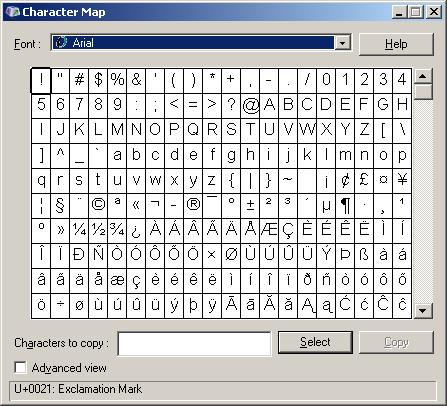

The Buzzard Posted October 27, 2010 Share Posted October 27, 2010 OK, A little more insight with UNICODE. I made two ALERT lisps similar to each other using the UNICODE symbol: U+00D8 Latin Capital Letter O With Stroke. There is a difference in appearence because of the saving method that was used. GARBLE2.lsp has the Encoding set to ANSI and GARBEL3.lsp was set to UTP-8. You can see the difference in the images below. (defun C:garble2 () (alert "GARBLE2.lsp 6\" Ø") ) (defun C:garble3 () (alert "GARBLE3.lsp 6\" Ø") ) Although both were written similar they appear different due to the saving method. I am still not sure if this is the cause of the OP's original problem, But its interesting just the same to see the affects from a learning perspective. Please note that this only affected the UNICODE symbol itself. Quote Link to comment Share on other sites More sharing options...
