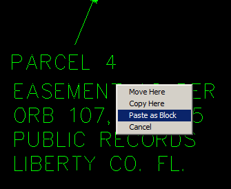

alanjt Posted October 28, 2010 Share Posted October 28, 2010 If you are just making random blocks (with random insertion points), who cares what they're named. You can actually make quick anonymous blocks by selecting the objects you want, holding the right-click down and dragging the objects. From there you will receive a prompt to move, copy, paste as block. eg. However, if you are going to specify the name, you need to consider checking to make sure the name is valid (use snvalid function) and make sure the block name doesn't already exist (tblsearch "BLOCK" ). Quote Link to comment Share on other sites More sharing options...
