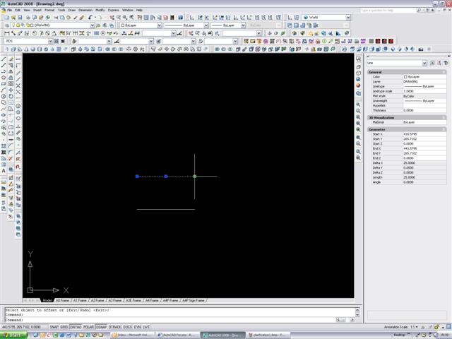

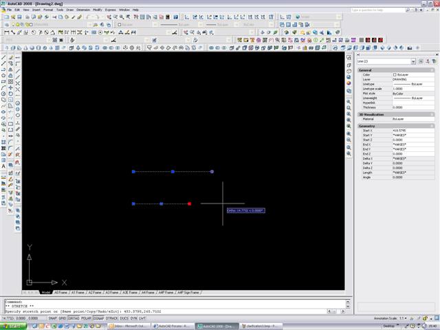

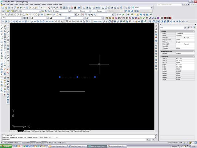

skipsophrenic Posted September 18, 2008 Share Posted September 18, 2008 How on earth do i set up the UP arrow to repeat last keybard entry, and NOT when i've got hold of a grip to select last absolute position. e.g. - i got 2 lines 25 units apart, i select the top on, drag it's end grip horizontally by 10, i then press escape, and select the lower lin, got to extend it's grip, (Out of habit) press up and enter, and instead of direct distance entry to 10 units, it goes to the absolute co-ordinat of the last endpoint I moved previously. Sorry if I confused people here with above sentence, if clarification required please do not hesitate to let me know. Quote Link to comment Share on other sites More sharing options...

skipsophrenic Posted September 18, 2008 Author Share Posted September 18, 2008 Clarification!! Thanks ok got two lines i select the top one extend it by its end grip by 10 to the right do the firs two options with the bottom line, and press the up arrow, instead of just putting number ten in command bar like in '07, '06 & earlier releases, it goes to the absolute co-ordinate point of the new end position of top line Quote Link to comment Share on other sites More sharing options...
rkent Posted September 18, 2008 Share Posted September 18, 2008 INPUTHISTORYMODE set it to 6. See Help also. Quick Tip: Type INP and hit tab. Quote Link to comment Share on other sites More sharing options...
skipsophrenic Posted September 18, 2008 Author Share Posted September 18, 2008 Cheers rkent that got it Quote Link to comment Share on other sites More sharing options...
