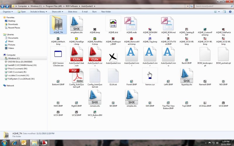

Alex B Posted November 11, 2010 Author Share Posted November 11, 2010 Here is an image of the folder contents... Quote Link to comment Share on other sites More sharing options...
alanjt Posted November 11, 2010 Share Posted November 11, 2010 AQME.dvb = VBA. Unless it's not password protected (unlikely if you paid for it), you'll have to contact the developer. Quote Link to comment Share on other sites More sharing options...
