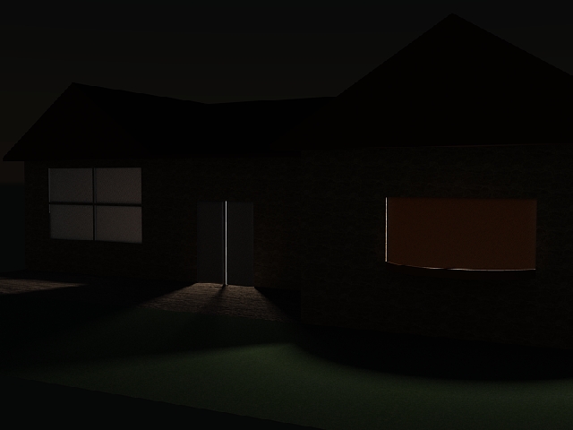

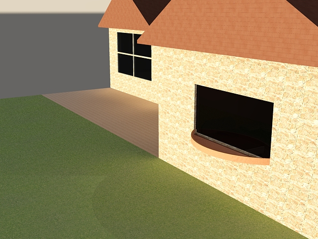

I have a hp Laptop works great with all the software i have no problems except while rendering in autocad.the cpu stays at 1.73 ghz although its a core i7 and its max frequency is 2.86 or 2.93 does anyone have the same problem any fixes?

Looking at your render, I don't see any reason for your processor speed to increase. That scene looks very simple and basic.
What was the total render time? I'm guessing probably less than 10 seconds? There is no need for your processor to do anything really.
Try building something very complex, apply some highly reflective materials, enable Global Illumination & Final Gather and adjust your render settings up for very high quality. Then hit Render and watch your processor speed. I'm sure you will see a speed increase.

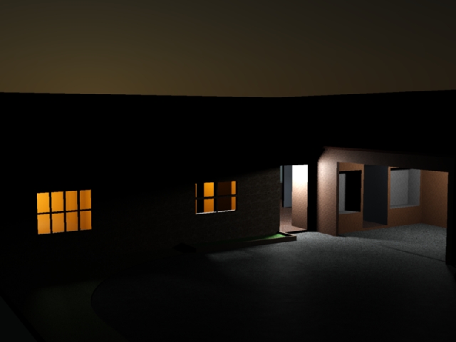

i rendered all of those images some at 800x600 some at 1600x900, my cpu stays at 1.73 ghz no matter what. at 1600x900 =+30 minutes
640x480 and 800x600 it takes about 15-20 minutes
