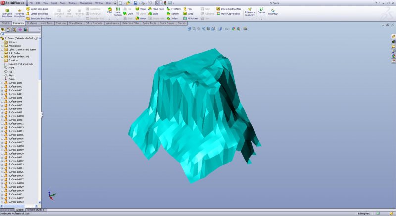

Tyke Posted November 22, 2010 Author Share Posted November 22, 2010 So here's a few extracts from the project. A DWG with some contours as polylines as gernerated from a DTM (LW-Polylines, but they can be converted into either 2D-polylines or 3D-polylines if necessary). A DWG with 3D faces as extracted from the TIN from the DTM. An ASCII file with 1000 X,Y,Z coordinates as a comma delimited file. Both the DWGs are in AutoCAD 2004 format. The origin of the files is the regional coordinate system, let me know if they need transforming to a local grid with smaller numbers. Let's see if any of these formats are of any use in SW in creating a solid. contours 5m grid 2004.dwg 3D faces 5m extract 2004.dwg points_5mx5m_extract.txt Quote Link to comment Share on other sites More sharing options...
bhamze Posted November 22, 2010 Share Posted November 22, 2010 I was able to open both the contour and 3D face files. I had no luck with the text file. Attached are images of both. What do you guys think? Quote Link to comment Share on other sites More sharing options...
Tyke Posted November 23, 2010 Author Share Posted November 23, 2010 Hi Bill, Are both of them surfaces or solids, or do you have the contours just as lines? Which of them were the easier to read in. How can explain to my guy how he should read in the data, no doubt its dead simple, but I don' have SW and have no knowledge of the commands or import procedure. Quote Link to comment Share on other sites More sharing options...
shift1313 Posted November 23, 2010 Share Posted November 23, 2010 Tyke i didnt have time to try and mess with this but looking at bills screen shots the first image is only curves, the second image is surfaces. Quote Link to comment Share on other sites More sharing options...
bhamze Posted November 23, 2010 Share Posted November 23, 2010 Matt is correct. The first image consist of curves and the second with surfaces. I did no manipulation to your files. Both of these models were generated as a direct import of said files. Both are easy to read. The question is....what are you trying to accomplish? Does the model require a smooth finish? Is the image of the surface file above acceptable? Does model need to consist of a solid body? Both files can be manipulated to become a solid. Both will require some work. The contour file however will be much more involved, as the user will need to create each of the faces/surfaces to create the solid model. Either way........both should work. When I get home I will make a video demonstrating how to import the files into SW. It's simply yes......but the video will clarify what selections need to be checked. Hi Bill, Are both of them surfaces or solids, or do you have the contours just as lines? Which of them were the easier to read in. How can explain to my guy how he should read in the data, no doubt its dead simple, but I don' have SW and have no knowledge of the commands or import procedure. Quote Link to comment Share on other sites More sharing options...

Tyke Posted November 24, 2010 Author Share Posted November 24, 2010 Hi Bill, The contour file would take forever in SW to do as there is a huge number of very complex contours. The contours have a 1 metre spacing amd there's almost 250 m level difference in the full job, this here was just a small part. The 3d faces would be acceptable (I think) and the 5 m grid has already been accepted. As the final model will be produced to a scale of between 1:500 and 1:1000 I don't think any smoothing will be necessary. If possible I would leave creating a solid to my client, if he really wants it as a solid. I've optimized the AutoCAD side a bit so the whole thing can now be completed in an acceptable time. I looked at your video and it shows all the pertinent steps to get the job done in SW. Must it be done as a sheet metal part or would it work just as well as a surface? If it's alright with you I would like to copy your video to CD and show it to my client. I'll get back and let you know how it goes. Many thanks to Bill and Matt for the all the help and advice. Quote Link to comment Share on other sites More sharing options...

Tyke Posted December 20, 2010 Author Share Posted December 20, 2010 Thanks guys, we managed to import the 3d faces and also a sample from the contours and the man then achieved what he had intented to do. It turns out this job was the biggest he has ever attempted and the normal ones are much smaller. He is happy with the results and will be coming back with other work, or so he says. All the help is appreciated. Quote Link to comment Share on other sites More sharing options...
