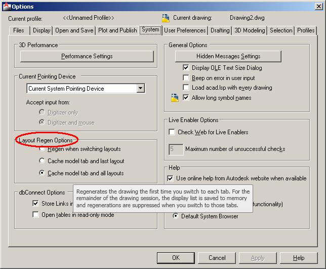

nestly Posted November 22, 2010 Posted November 22, 2010 Memory/process usage isn't something I know much about but this seems like it would weigh heavily on memory usage. Quote
ReMark Posted November 22, 2010 Posted November 22, 2010 (edited) Yes that's a known resource sucker. It can also be accessed via LAYOUTREGENCTL. Another memory hog has to do with hatch preview. Control this with the variable HPQUICKPREVIEW. AutoDesk is recommending something called the Performance Monitor. Check it out here: http://labs.autodesk.com/utilities/acad_perf_mon/ The download is free however you have to sign-in just as you would when visiting the Discussion Forums. Interestingly enough the 1.06MB zip file (Monitor.gadget.zip) is touted as an AutoDesk Labs Pre-release Product. Huh? I wonder what the mystery is all about? A search of the AutoCAD 2011 discussion group indicates users complaining about slow performance in regards to all of the following features... Array Copy Hatch Plotting Regen Scrolling Selecting Space switching Undoing Zooming These plus the infamous "out of memory" error seem popular since 2009 was released and just got worse with 2010 and 2011. Edited November 22, 2010 by ReMark Quote
