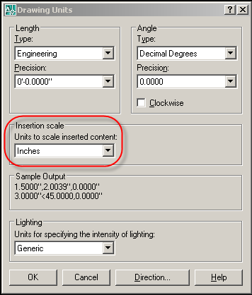

Polly Posted September 19, 2008 Posted September 19, 2008 Hi everyone, Does anybody know what happened and how to fix this problem? The problem is I had a drawing and I think it's from architectural firm. Someone scaled the drawing down from 12 units to 1 units. I checked the units and it said "Unitless", but when I inserted brand new block scale 1=1, the block was way too big (it looked 12 time bigger than it should be). I had this problem only when the drawing was scaled down. If the drawing was drawn at true scale from the start I won't have this problem with my block. Thank you. Quote

Polly Posted September 19, 2008 Author Posted September 19, 2008 I'm in engineering firm doing street improvement such as striping, which should show the lane width of 12' or 11' or 10', etc. Somehow the drawing I have problem with was drawn 12 times bigger. I checked the block scale and it showed 0.0833. Every block I insert need to be in that scale. Why is that? Quote
dbroada Posted September 19, 2008 Posted September 19, 2008 a 12 times scale factor suggest to me that one of you is draing in inches, the other feet. Quote
Polly Posted September 19, 2008 Author Posted September 19, 2008 Dave, I know that. I just want to know how to fix it so next time I insert the block I don't have to use 0.08333 for the block scale. Quote
CmdrDuh Posted September 19, 2008 Posted September 19, 2008 It sounds like the units dialog box needs fixing. Type in units and see what it says Quote
dbroada Posted September 19, 2008 Posted September 19, 2008 look at the INSUNITS variable. It will force the inserted block to use a different unit system Quote
Polly Posted September 23, 2008 Author Posted September 23, 2008 I check both places and it said unitless, which is what I want it to be. Quote
CmdrDuh Posted September 23, 2008 Posted September 23, 2008 It might be possible that the inserted block has a scale factor inside the block definition. If you open the block your inserting, and open the block editor, what does the properties page look like? Quote
dbroada Posted September 23, 2008 Posted September 23, 2008 I check both places and it said unitless, which is what I want it to be. I prefer unitless but AutoCAD now makes assumptions as you have already seen. However because of these assumptions I am beginning to declare the block unit. Look at the variables in the INS* area and you can set these to force your inserted block to be feet, inches, or whatever. Quote
Polly Posted September 23, 2008 Author Posted September 23, 2008 I check the block that I created and it has unitless also. I have problem with AutoCAD2009 if the drawing is unitless and the block is in inches. that's why I use unitless to create the block. You know what I might block the whole thing out and bring it in again, kinda like start fresh. I hope my theory is working. thank you so much for all your advice. Quote

Polly Posted September 24, 2008 Author Posted September 24, 2008 Nellie, I don't know what you're talking about. Anyway, if the drawing originally set the units to be FEET, what can I do to make it unitless. I can change the units at dialog box, but it won't affect anything. After I inserted the block, which its text height = 0.1, the text height will equal 1.2 instead of 0.1. Quote
