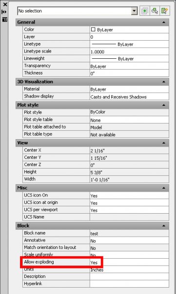

Cad64 Posted December 1, 2010 Posted December 1, 2010 I can not find the "Allow Exploding" in the properties palette ... I am using Autocad 2010... See below: Quote
