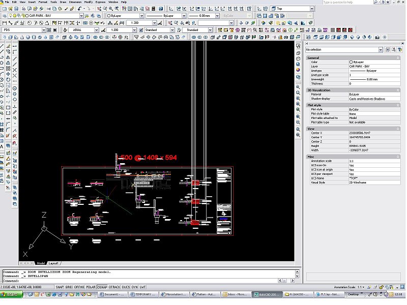

skipsophrenic Posted September 22, 2008 Posted September 22, 2008 Hi URGENT I've got the problem that I've been asked to update a drawing by changing the width of 3 rectangles - no problem right? WRONG, The drawing was originally done in microstation and then converted to dwg, now when I open it, it views ok apart from the fact everythings at a weird ucs angle, and the flatten command wont work. This is the text i get in the command bar Command: flatten Initializing... Select objects to convert to 2d... Select objects: Specify opposite corner: 3887 found Select objects: Remove hidden lines? : 20 were not able to be exploded. bad argument type: lselsetp nil See screenshot for explanation of ucs problem - Quote

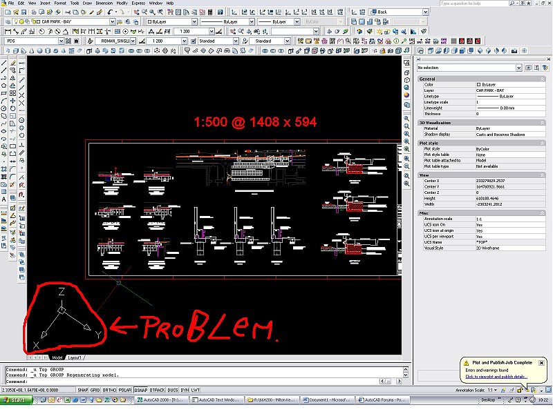

skipsophrenic Posted September 22, 2008 Author Posted September 22, 2008 no joy with the lisp heres a screengrab, the lines goin up intersect some loooooonnng lines goin horizontal about 10m up:? Quote
