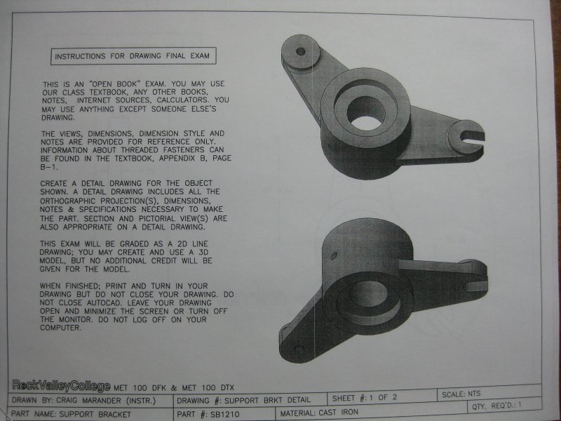

dieselixi Posted December 15, 2010 Author Posted December 15, 2010 So, I took the final today, It wasnt that bad just under a little presure because of the time limit. Im going to post the the final on here for anyone that whats to give it a try. I want to thank everyone for all the help and advice. Quote

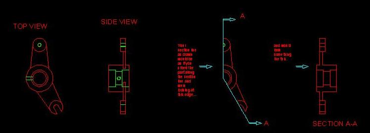

JD Mather Posted December 15, 2010 Posted December 15, 2010 What standard? ANSI standard leading zeros are suppressed in inch drawing (not in metric). Cylinders are dimensioned in rectangular view preceeded with Ø symbol. Words like depth and counterbore are no longer used - use symbols. Full circles and holes dimensioned as diameter - considering the manufacturing process eg a drill is specified by diameter size. See attached for solution. Test.zip Quote
JPlanera Posted December 15, 2010 Posted December 15, 2010 (edited) JD, I think the instructor may have dimensioned that way on purpose... Notice the Note "DIMENSIONS AND DIMENSIOIN STYLE ARE FOR REFERENCE ONLY". I assume the reasoning for this is to prevent people from "copying"... I would suspect he expects his students to point out the fact that it is not dimensioned as the standard suggests. BUT, im not a teacher... How do you present this type of problem to your students? Edit: I re read your post JD, and it looks like you were pointing that out already... The posted "solution" gave it away... Ha! I think my new rule is, "Drink at least one cup of coffee in the morning before posting on CADtutor..." Edited December 15, 2010 by JPlanera I think I take it back.... Quote
