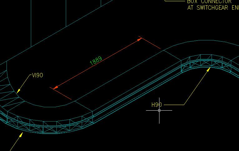

truant Posted September 22, 2008 Share Posted September 22, 2008 Hello, I have an isometric view in paper space of a 3d model in model space, I need some dimensions, but I am having trouble. I created a "Aligned Dimension" then I oblique it so it is in the proper plane. The problem is, its only taking into account the 2 dimension of paper space, and my dimension measuerments are coming up to small. (i dont think its a scale issue, I have tried with a 1:1 viewport) If you need further explanation or a screen shot to help me, please let me know. Thank You, Quote Link to comment Share on other sites More sharing options...

truant Posted September 22, 2008 Author Share Posted September 22, 2008 I cant the upload .dwg, but here is a screenshot, That dimension is wrong, it should be 2313. Quote Link to comment Share on other sites More sharing options...
lisplost Posted September 22, 2008 Share Posted September 22, 2008 Are these duct banks? Is this the Model view or the Paper space view? One way you can change the length by overwriting the text in properties, since you know what it should be. Quote Link to comment Share on other sites More sharing options...
truant Posted September 22, 2008 Author Share Posted September 22, 2008 Are these duct banks? Is this the Model view or the Paper space view? One way you can change the length by overwriting the text in properties, since you know what it should be. the dimension and the screen shot are from paper space I know the text override would work, but in are client spec they talk about not using that. That is cable bus from a TX to Switchgear. Quote Link to comment Share on other sites More sharing options...

shift1313 Posted September 22, 2008 Share Posted September 22, 2008 as far as i know the dimensions will only work in the xy plane. from the view the dimension lines appear to be in the correct orientation. if you but your UCS at one of the points of interest and select the other one, what does your coordinates say the location is? Also you can use the measure(little ruler icon) and it will give you a total distance, and x,y,z distances. Quote Link to comment Share on other sites More sharing options...
nocturne00 Posted September 23, 2008 Share Posted September 23, 2008 the dimension is not wrong, its just dimensioning it as though it were a flat object, not an isometric object. the dimension registering is taken from the drawing but treated to be on a 2D plane, eg a flatshot of flatten image. im not sure if there is a variable to set it to measure the actual length on paperspace. to get the actual measurement you must dimension it directly on the 3d object, but to do that you must always be resetting you UCS Origin to the plane of the object you want to dimension. Search the Forum for a topic like this, there are some step by step procedures on how to do this Quote Link to comment Share on other sites More sharing options...
