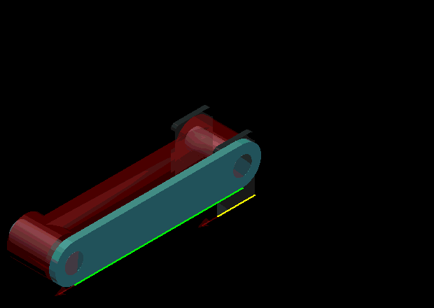

AFitchguy07 Posted December 20, 2010 Share Posted December 20, 2010 (edited) I am having trouble getting this assembly to move back and forth. I can't get the constraints to work properly w/o errors. Here is the entire assembly file and it's dependents: > Original > Redone Edited December 20, 2010 by AFitchguy07 Quote Link to comment Share on other sites More sharing options...
kencaz Posted December 20, 2010 Share Posted December 20, 2010 Try driving an angular constraint between the pivot arm and the grounded bracket... KC Quote Link to comment Share on other sites More sharing options...

AFitchguy07 Posted December 20, 2010 Author Share Posted December 20, 2010 i use directed angle and tried to enter angle of say 15 degrees and this error shows: Quote Link to comment Share on other sites More sharing options...

rdharvey Posted December 20, 2010 Share Posted December 20, 2010 as in if you read the error its having problems rebuilding a feature of geometric references have been lost. although sometimes the error boxes are useless haha. i'll have a look when i get chance. Quote Link to comment Share on other sites More sharing options...
AFitchguy07 Posted December 20, 2010 Author Share Posted December 20, 2010 as in if you read the error its having problems rebuilding a feature of geometric references have been lost. although sometimes the error boxes are useless haha. i'll have a look when i get chance. Oo yeah i read that too but i don't fully understand what it means. I've only been using inventor since this semester started. I don't understand why i can't get it to work when kencaz seemed to have gotten it to work with just adding an angle constraint at the two edges indicated in his avi. Quote Link to comment Share on other sites More sharing options...
rdharvey Posted December 20, 2010 Share Posted December 20, 2010 right, i have just had a look. I also have got it to work. I deleted all your constraints and used the insert constraint, you had way to many flush constraints that where not needed. i then placed an angle constrain and made the constraint driven... i'll try upload the asm now. Quote Link to comment Share on other sites More sharing options...

AFitchguy07 Posted December 20, 2010 Author Share Posted December 20, 2010 right, i have just had a look. I also have got it to work. I deleted all your constraints and used the insert constraint, you had way to many flush constraints that where not needed. i then placed an angle constrain and made the constraint driven... i'll try upload the asm now. well i didn't manually add any constraints. They all formed automatically i guess. I was told to make it fully adaptive so if the pin changes diameter, then the other holes would match and i did get that to work. I don't understand the flush constraints (whether they are needed or not). Quote Link to comment Share on other sites More sharing options...
AFitchguy07 Posted December 20, 2010 Author Share Posted December 20, 2010 (edited) Okay so this is getting really ridiculous and frustrating... I deleted all and started over. I built each part separately via part file then put them in assembly and used constraints to get it where i want. BUT now it won't adapt to changes that i make like it did before... such as the hole and length of inner/outer rods. I will keep the existing zip that has the files that the previous guys have downloaded and edited along with this new one that i have just created. The OP has been updated with these new files. Thanks again for the help! Edited December 20, 2010 by AFitchguy07 Quote Link to comment Share on other sites More sharing options...
kencaz Posted December 21, 2010 Share Posted December 21, 2010 Okay so this is getting really ridiculous and frustrating... I deleted all and started over. I built each part separately via part file then put them in assembly and used constraints to get it where i want. BUT now it won't adapt to changes that i make like it did before... such as the hole and length of inner/outer rods. I, (we), are aware that the lesson was on adaptivity, however, I think you need to get a better grip on constraints before diving into adaptive parts and sketches... It really makes it easier when you understand how your constraining your parts first... Just a thought... KC Quote Link to comment Share on other sites More sharing options...
