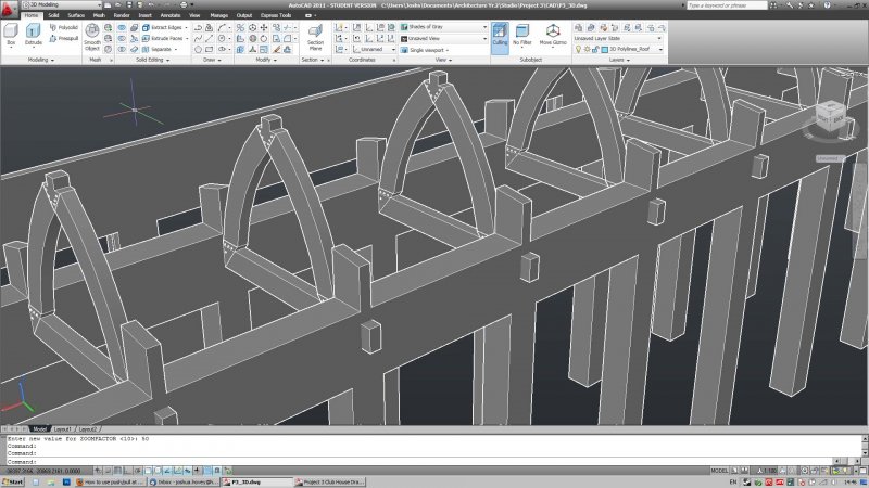

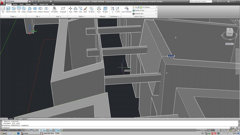

Posho91 Posted December 21, 2010 Share Posted December 21, 2010 Hi again folks, Encountered another issue with my model, I have windows which i want to create above the ends of the beams on either side as in the picture, ive created the window boundary with lines then used push/pull to try to push the window spaces down, but since my roof is already pitched, the push/pull tool is going at the wrong angle as you can see. Is there a way to change the angle to stay on the z axis...or an alternative method? thanks. Quote Link to comment Share on other sites More sharing options...
kencaz Posted December 21, 2010 Share Posted December 21, 2010 Press-pull will always extrude perpendicular from the profile. You can either angle your profile with the roof pitch or use dynamic ucs and draw your profile on the already angled surface. KC Quote Link to comment Share on other sites More sharing options...
Posho91 Posted December 21, 2010 Author Share Posted December 21, 2010 What do you mean by 'draw your profile on the already angled surface'? Quote Link to comment Share on other sites More sharing options...
JD Mather Posted December 21, 2010 Share Posted December 21, 2010 Set your ucs to desired plane before drawing the profile to presspull. You might also investigate Sweep as it might be easier depending on your design intent. Quote Link to comment Share on other sites More sharing options...

Posho91 Posted December 22, 2010 Author Share Posted December 22, 2010 Sorted this in the end using boxes sunk into the top of the roof, then subtract. My laptop isnt coping very well though, i've got 4gb of ram but I have to save frequently and close/open ACad to flush the ram else i get 'out of ram' errors. Sigh... Still, i'm starting to get the hang of the different tools. Quote Link to comment Share on other sites More sharing options...

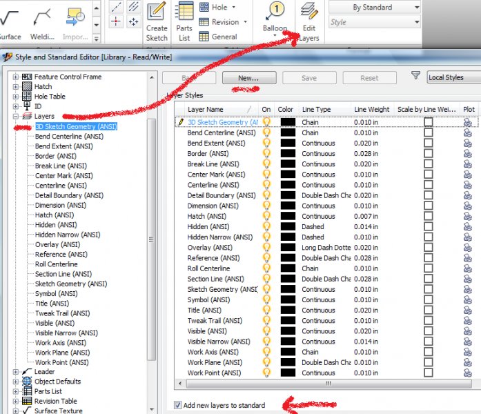

CADkitt Posted December 23, 2010 Share Posted December 23, 2010 Do not underestimate the power of a 15 year and his computer. And I hate layers too for some industries layers are complete bull****. That's why you won't see layers in Inventor or solidworks etc. btw with layers reactors from leemac in my industry you can close the layers menu almost completely. Quote Link to comment Share on other sites More sharing options...
JD Mather Posted December 23, 2010 Share Posted December 23, 2010 That's why you won't see layers in Inventor..... I guess you aren't very familiar with Inventor.... Probably best to keep this discussion on AutoCAD. Not sure what the problem would be with using layers in AutoCAD? Around here - set it in standard template and forget it. Quote Link to comment Share on other sites More sharing options...

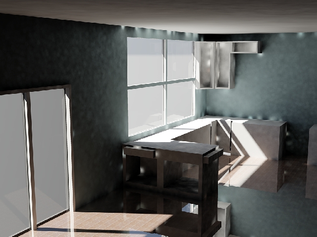

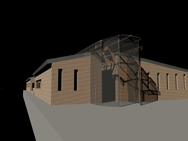

Posho91 Posted December 23, 2010 Author Share Posted December 23, 2010 Almost there now Not too bad for my first ever autocad model Quote Link to comment Share on other sites More sharing options...

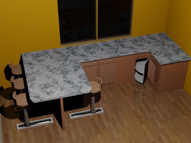

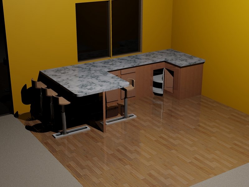

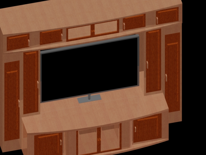

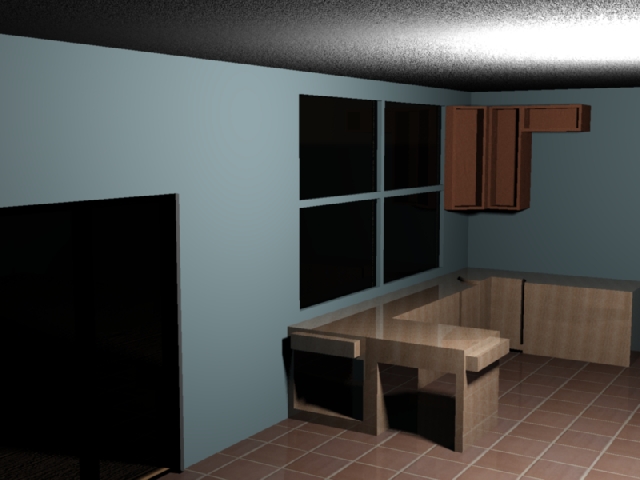

Raudel Solis Posted December 23, 2010 Share Posted December 23, 2010 here are some random renders of stuff ive done, 2 look blocky but i couldnt find the finished renders >:0.If you have been working for autocad for over a decade, then your view of information would be too broad since you might have been working with autocad versions 2002-2010 or 2011 depending on economic status, instead of just focusing on 1 or 2 autocad versions. which i have lots of time to do by just sitting down with autocad 2011 and going off at random modeling from stools, to kitchen cabinets, to large tv furniture/centerpiece like the 1 above, and some others i got in a rusty external hardrive (not actually rusty). layers are simple i messed with them because of remarks comment about "back of the class for you" , I seperated my current project into catagories : master beed room, 2d bedroom, 3rd bedroom, Kitchen Appliances/objects, quite simple, hide unhide, freeze unfreeze , and btw dont forget im 15 so dont expect something like a rotating skyscraper rendered with perfect illumination and refractions Quote Link to comment Share on other sites More sharing options...
