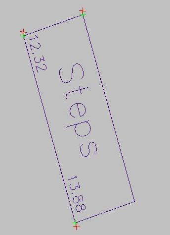

I have a survey drawing that has a lot of point without elevation and I have a dwg from another source that has Z elevation to the points, the problem is that the points are not exactly at the same position. Iam just checking the properties and editing the z for each point individually at the property manager.
Is there any lisp that will match the Z elevation from source to target, Red are the points with Z and green are the points without Z

Given that:
  • The Red And Green colors are forced on the point entities ( not BYLAYER with their respective layers )
  • My guess is that your tolerance would 1 unit ( probably meter )
  • PDMODE hasn't changed since the last REGEN
  • PDMODE display geometry will be included in the Tolerances
Just to name a few....
You could do away with the tolerance, but a drawing with thousands of points would be slower than molasses in the Arctic.
Have fun! -David

Thanks, By comparing every point to every other point, the iterations would grow exponentially. I guess you could try to calculate a ssget crossing value, but it would still be a guess. -David
Lot of thanks and appreciation to you Mr. David, hope my work load will get lighter.
Mr. David, is there any way that I can work layer by layer or area by area instead of all the features in one shot. Here there are many features who different level one above the other like the road and the bridge, etc

symoin,
Yes, There are lots of ways that you could break out the selection sets.
You would have to have some consistent parameters to work from. ie layer names, point colors.
You can remove the "X" from ssget call to allow for user selections as well. -David
