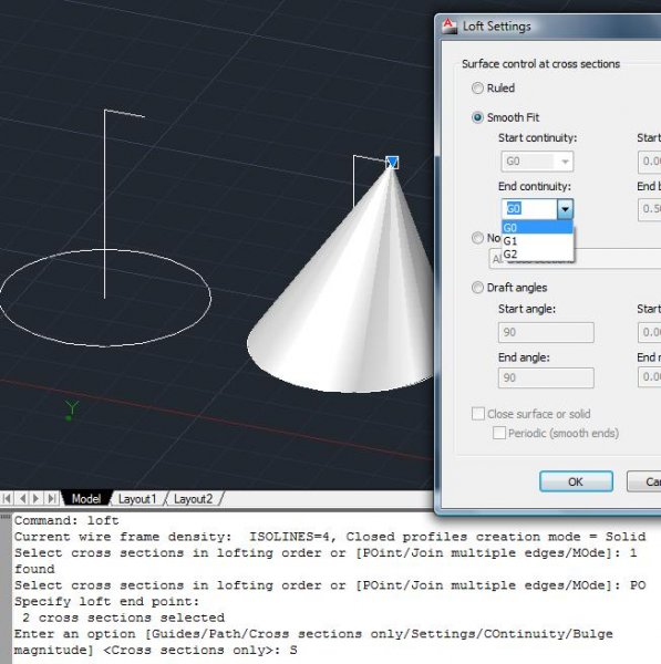

crosithious Posted December 31, 2010 Share Posted December 31, 2010 hello, i've been trying to find a way to create a cone with an "non-centered" point. That point being 2 units from the center of the circle. here's the dimensions. R=5 H=10 center of the height is moved 2units down from the center of the cone any and all help is appreciated. thank you Quote Link to comment Share on other sites More sharing options...

JD Mather Posted December 31, 2010 Share Posted December 31, 2010 Circle radius 5 Line up 10 over 2 Loft - pick circle PO click apex endpoint S change Settings to G0 continuity. (see attached) (you might change facetres to 10) Quote Link to comment Share on other sites More sharing options...
crosithious Posted January 4, 2011 Author Share Posted January 4, 2011 i tried what ya'll posted and it worked. Thank you Fuccaro for the links and advise and thank you JD Mather for the tutorial-in-a-picture. Quote Link to comment Share on other sites More sharing options...
