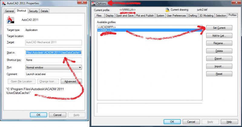

I don't have AutoCAD Architecture, but here is a screen shot of the Properties for my AutoCAD Mechanical to run as vanilla AutoCAD.
It should be something very similar for AA.
Replace the Start In with path shown (with appropriate replacement for \ACADM 2011\ ) and start program and check Options set to vanilla Profile.
When the program installs, it asks you if you want the shortcut to run just autocad (well, my aa 2007 did, can't speak for anything newer). if you (or whoever installed it) didn't click yes, then it didn't put the shortcut on there for you. JD's suggestion above should fix it for you.
