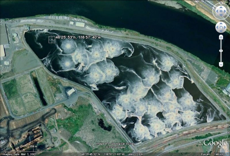

eldon Posted January 9, 2011 Share Posted January 9, 2011 Might this be the place? If it is, then your coordinates are in decimal minutes of Latitude and Longitude. Quote Link to comment Share on other sites More sharing options...

fokerss Posted January 9, 2011 Share Posted January 9, 2011 Might this be the place? If it is, then your coordinates are in decimal minutes of Latitude and Longitude. [ATTACH]25638[/ATTACH] wow i new too , how you do that ? Quote Link to comment Share on other sites More sharing options...
