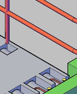

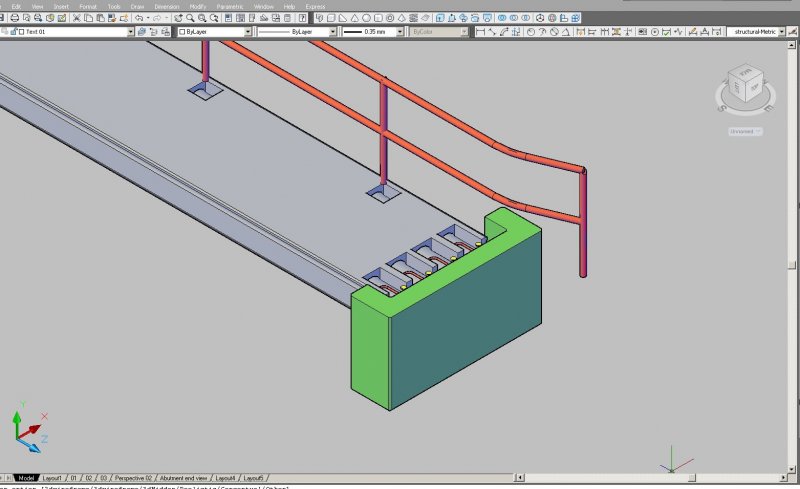

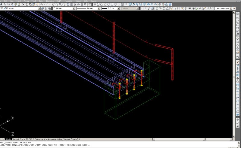

JimB Posted January 10, 2011 Posted January 10, 2011 Now you can see how from this folder that is over a GIG in size (if I wan to print takes ages but these things are tiny. And I can capture waht ever I want and just paste.... Quote
