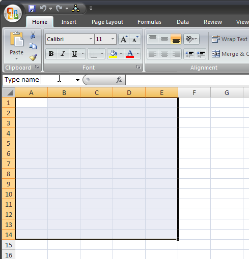

irneb Posted January 11, 2011 Posted January 11, 2011 A data link. Can all cells be unlocked at one time and remain unlocked?Not too sure ... I've found updating to sometimes screw up this (especially if there's new rows / columns). Now that the table has been inserted, to update - if needed - I use datalinkupdate, correct? Of course I will need to re-set the range.If you find the range is constantly changing, you may rather want to use named ranges in Excel. That way you don't need to modify the data link each time ... just ensure that Excel's named range points to the correct cells (which should update automatically if you insert or delete rows / columns). In Excel 2007 you add / redefine named ranges here: Quote
Marc5 Posted January 11, 2011 Author Posted January 11, 2011 So true on the DATALINKUPDATE. Thought I was doing something wrong. I have to erase link in CAD and re-insert if the link needs to be updated. I have found it will not update NEW rows, too. I will give the excel's named range a try. Thanks for the advice. Marc Quote

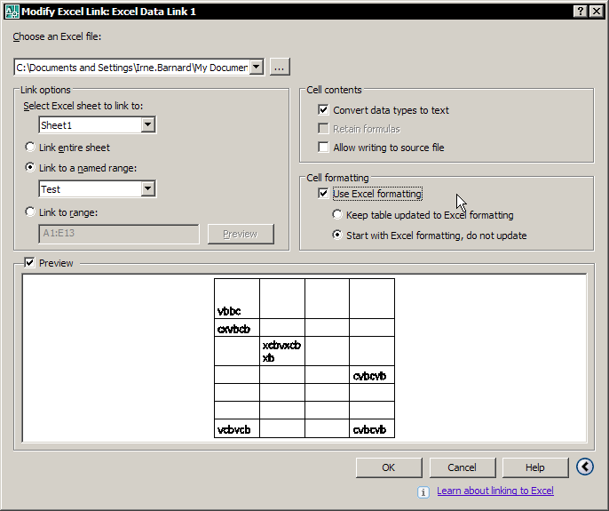

irneb Posted January 11, 2011 Posted January 11, 2011 What you can also try is to either turn on / off formatting from Excel. When editing the data link in ACad's Data Link Manager, notice there's an expand button on the bottom right - this grows the dialog to show some extra options. Maybe one of these should help in your scenario. Quote
