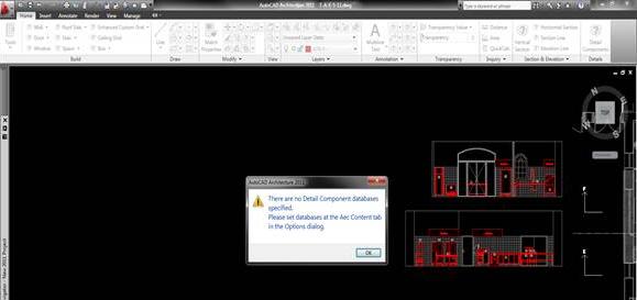

kasper_4000 Posted January 12, 2011 Posted January 12, 2011 My detail components, walls, stairs, slabs etc. are all shown with a question mark.. When I go to options/AEC content, it shows the right file path... What is wrong here?? Quote
kasper_4000 Posted January 12, 2011 Author Posted January 12, 2011 Nothing were xreffed.. It just seems that autocad can't my the folders (enu folder) in which, design, documentations and that should be.. As if something wasn't installed right.. Quote
ReMark Posted January 12, 2011 Posted January 12, 2011 Maybe I'm missing something here. Why would your detail components be stored in the enu folder? Quote
kasper_4000 Posted January 12, 2011 Author Posted January 12, 2011 It's the AEC content folder that is missing.. Weel it's not missing but autocad doesn't seem to able to locate it. C:\ProgramData\Autodesk\ACA 2011\enu\AEC Content Quote
ReMark Posted January 12, 2011 Posted January 12, 2011 Seems odd. The path to this folder is included in your software's search path correct? Quote
