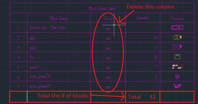

So I have tried Lee-Mac's 2 block counters. I don't want another Block counter. I do however want to understand how to modify this Block Counter that I found. I don't remember where I found it (it could have been from here @ cADTutor).
I made a change in some of the table heading from Vietnamese to English. However, I want to know how to delete a column (maybe 2). And add a total option that gives a total of all of the blocks.
I don't want another block counter because I like how this one asks for the text height and allows for a selection set by either picking individual blocks or by a window (I have no need for a global block counter).
I would like to get rid of the column "Don vi" and possibly the first column. I have tried commenting out (;) some lines but that doesn't seem to work.
Thanks for any help

     (setq j -1 header_lsp (list "    " "Block Name" "Don vi" "Quantity" "Preview"))
     (repeat (length header_lsp)
(vla-setText TblObj 1 (setq j (1+ j)) (nth j header_lsp)))
     (setq row 2 i 1)
     (foreach pt lst_blk
(setq blk_name (car pt) j -1)
(mapcar '(lambda (x)(vla-setText TblObj row (setq j (1+ j)) x))
	(list i blk_name "cai" (cdr pt)))
(vla-SetBlockTableRecordId TblObj row 4 (GetObjectID (vla-item blks blk_name)) :vlax-true)
(vla-SetCellAlignment TblObj row 1 7)
(vla-SetCellAlignment TblObj row 3 9)
(setq row (1+ row) i (1+ i))	)
