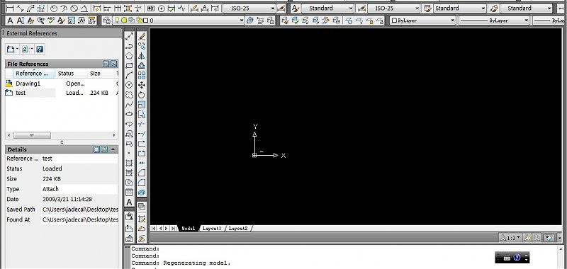

ichlove Posted March 20, 2009 Share Posted March 20, 2009 Hi VVA, 1.Our Model background was black,but when I tried white or grey,it still doesn't work,no source drawing. 2.Because sth conflict with our customise system,our CTRL + A command is disable,so normally we just use mouse to select all.I tried mouse,still nothing happened.what I gonna do? thanks I bind grey source drawing and all ok.1. What color of your Model tab background? 2. If to use CTRL+A that something is selected? PS. From my practice. Colour of model Model tab background set to True color 0,0,0. Insert xref by black colour. Xref on model tab it is not visible, but it was selected on CTR+A. Quote Link to comment Share on other sites More sharing options...

ichlove Posted March 21, 2009 Share Posted March 21, 2009 Hi VVA, I have been tried your method,still doesn't work on my test drawing,I don't know why:(.Command line will show "Regenerating model"(see the attachment).Would mind post a smal video or screen shot about how you bind the drawing?By the way, the color of attribute has been changed,thanks a lot! Quote Link to comment Share on other sites More sharing options...
VVA Posted March 21, 2009 Share Posted March 21, 2009 I have found the decision of this problem. Similar, it is bug AutoCAD. In version 2006 all is normal. In versions 2008 and 2009 similar problems are observed. For bind of the xref use a command _CLASSICXREF and its option bind Quote Link to comment Share on other sites More sharing options...
ichlove Posted March 21, 2009 Share Posted March 21, 2009 Sorry,I tried the command & bind option,will show this.The strange thing is,when I don't change the xref color,the drawing can be bind.By the way,which cad version you use? I think I found the problem,as long as there is dimension ,the drawing will lost.but I don't konw how to slove it Quote Link to comment Share on other sites More sharing options...
VVA Posted March 21, 2009 Share Posted March 21, 2009 Yes, at me too such messages. Then try to change algorithm. Open a file test.dwg, run ColorX and change colour to 252 and then insert as xref. Quote Link to comment Share on other sites More sharing options...
ichlove Posted March 22, 2009 Share Posted March 22, 2009 Hi,VVA,thanks for the solution. This can slove the problem,but not the best way.Because we don't want to change anything from the source drawing. BTW,when I use colorxref,all the color can be changed,except the dimension one,maybe lisp code can help with that. Thanks a lot:) Yes, at me too such messages. Then try to change algorithm.Open a file test.dwg, run ClorX and change colour to 252 and then insert as xref. Quote Link to comment Share on other sites More sharing options...
