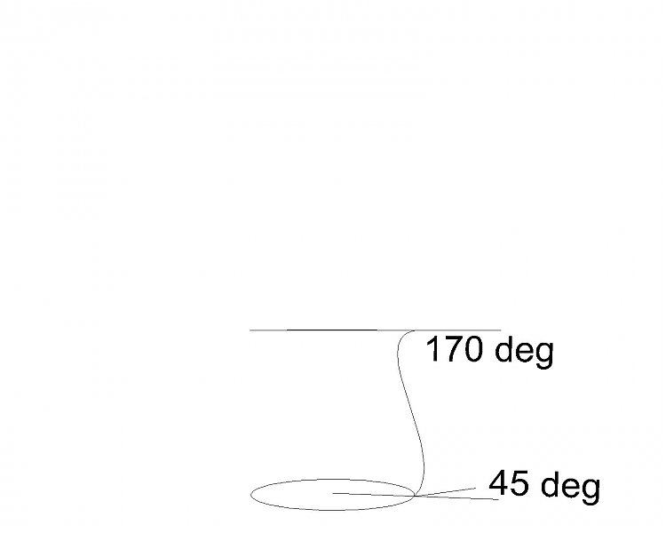

shift1313 Posted September 25, 2008 Posted September 25, 2008 say for instance you were lofting between two arcs. Normal to and draft angle 90 should be the same thing. your loft will be at 90 degrees from start/end arcs. If you change that angle to say150, the loft will bend closer to your defining arcs. If you enter a magnitude here, say 1.0inch, your loft will travel that distance before it starts to bend toward your other defining curves. Draw something simple like two circles and loft between them with no other defining curves. Here i drew a circle at 0,0,0 with dia 10. and another at 0,0,-10 dia 10. I did a loft between them with the draft angle at the start 170deg, and at the end 45 degrees. Quote
