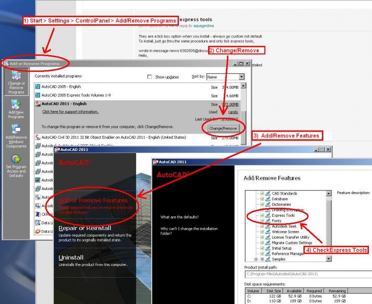

ReMark Posted January 13, 2011 Posted January 13, 2011 (edited) The option to load Express Tools is usually offered during the installation process. You may have to go back and add it. On second thought, before you attempt that I'd like you to check something. At the command line type: (findfile"acetmain.cuix") then press Enter. AutoCAD should return the path to the file. It should look similar to this: "C:\\Documents and Settings\\yourcomputernamehere\\application data\\autodesk\\autocad 2011\\r18.1\\enu\\support\\acetmain.cuix" If it does not find the file it will say "nil" I believe. acetmain.cuix = AutoCAD Express Tools Customization file. Edited January 13, 2011 by ReMark Quote
nestly Posted January 13, 2011 Posted January 13, 2011 If Express Tools are installed, Typing EXPRESSTOOLS will load them. If Express Tools are not installed, re-run the setup program, and add ExpressTools to your existing installation. Quote
