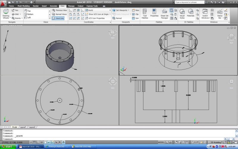

Okay I got a hang of the viewports. Is there an easy way to display all the dimensions now. Like is there a command that will display all dimensions and then I delete the ones I don't want? Or do I have to use a dimension command specific to each dimension? Like DIMDIAMETER to display the diameter of the part or DIMLINEAR to display the depth of those holes?
Yes you will need to use specific dim tools for diameter, radius, angle, linear, etc. Don't try placing dims on any isoviews as autocad will give the true projected length and not the model length.

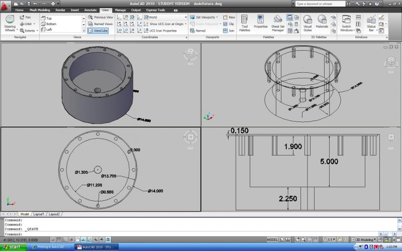

Okay I have placed the dimsensions I needed to in order to define the part. Now how do I clean it up a bit?
How do I delete some of the dimensions from being viewed in certain views, like the ones being shown in the top 2 views, or the one dimension being shown in the bottom left view?
How do I change the text size of the dimensions because I havent been able to figure that out? Or will I not have to do that until I decide to print the drawing?
You can go into one of the viewports and use layfrz command, pick a dimension and that layer will be frozen in that viewport. Or go into a viewport, start the layer manager, find the dim layer, look to the right for layer freeze/thaw, and pick on the freeze/thaw icon.
You may need to create another layer or two for dims and then you can place dims on separate layers and freeze those in the various viewports.
I see dims in the one iso view that are a long way from the model. You will want to relocate the UCS to the model before placing dimensions. And you may want to dimension in paper space instead of model.
Dimension text size can be a lot harder than it needs to be, let me see if there is a tutorial already set up on this site.
Okay I was able to figure out changing the dimension text size larger. But I am having trouble understanding you. I just want hide some of the dimensions in the top two viewports and then that one dimension "0.000" in the bottom left view. So isn't there a way I can just hide all dimensions in a viewport and hide just certain dimensions in viewport?
In AutoCAD the dimensions cannot be suppressed in a view. Layers can be frozen overall or per viewport. Like I said before, create other layers, set the dims on the layers depending on what you want to see or not see. You will go into a viewport, open the layer manager, find the layer name, follow the row over to the right to the freeze in VP and pick the sun icon to become a snow flake, that layer will be frozen in that viewport.

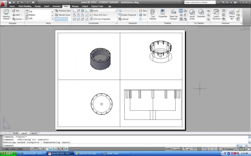

Okay I just figured out how to get into paper space. I have never worked in paper space so I am not really sure what to do. I want to make the viewports in paper space look like the the viewports shown in the model space, but I don't know how to go about changinging the views to look like that in paper space. I would greatly appreciate any help. Thank you.
You can use MView in paper space. You'll have to assign a scale to each viewport. I would recommend creating a separate layer for your Viewports and set the layer to "no print". Finally, I'd also suggest that you lock each viewport display so as not to change the scale.
