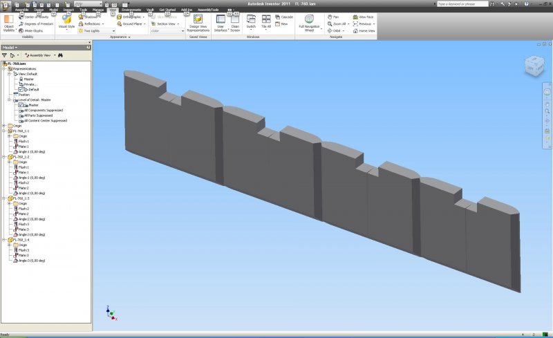

See attached file, angle between plates are 0 degrees, how do I make a new represenation where the angle is 90 degrees so they fold together? And I can switch between open and closed! I tried to make new representation but did not worked.
I suceeded at last, I made a new Position, and after I had to mark angles and choose "override" to accomplish my goal :-)
