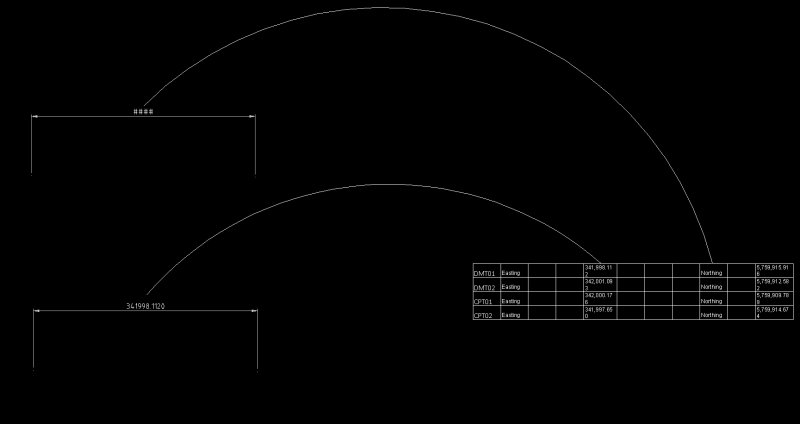

See the results of data fieds with text and numbers, the field with text is not showing correctly, I am using civil3D2009.
Im at loss at the moment... I will see if there is another way...
