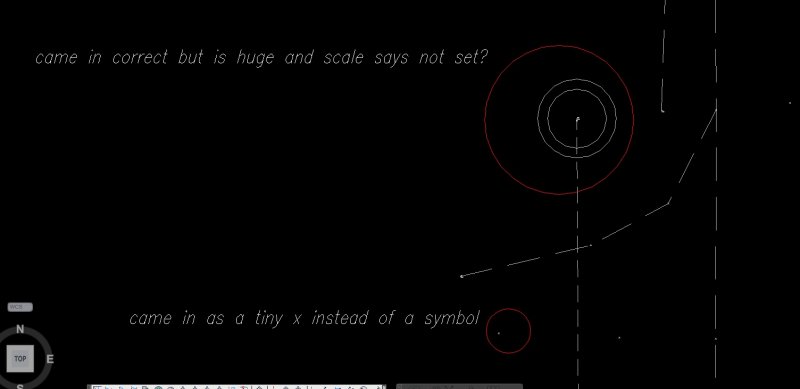

TiffF Posted January 18, 2011 Posted January 18, 2011 We just recently upgraded to Civil 3d 2011. I am trying to reduce a file but some of it's points come in as X's and list the description but the style name etc... are not known. It's mostly the elevation and corner shots. I have Description Keys and Point Styles set up for all of them. What could be causing this? Quote

TiffF Posted January 18, 2011 Author Posted January 18, 2011 No. I am importing an ascii file via the Data Collection. Most of the nodes I click on are fine they have the correct symbols and show the right properties, but a few are just small X's and have the right description, but that is it. I'm not sure why, I can't see what's different about them compared to the rest. Quote

lpseifert Posted January 18, 2011 Posted January 18, 2011 Sounds like you're importing points using Description Keys. If the description (raw description) of an imported point does not match the criteria in your Description Key Set, it will display as the default marker (red x). Quote

TiffF Posted January 18, 2011 Author Posted January 18, 2011 That's a picture of what's going on. I have specified in the Description Keys that they should come in at drawing scale, yet I just noticed even the ones that come in correctly say no scale when selected. Quote
TiffF Posted January 18, 2011 Author Posted January 18, 2011 The description matches the data both have the same codes. Quote

TiffF Posted January 18, 2011 Author Posted January 18, 2011 Wow... I figured out what it is for the reduction. Even the case matts. Some of the codes were cor instead of COR and that caused them not to come in. It never mattered in our last program. What would cause the scale issue though? When I have it set to drawing size. Quote
