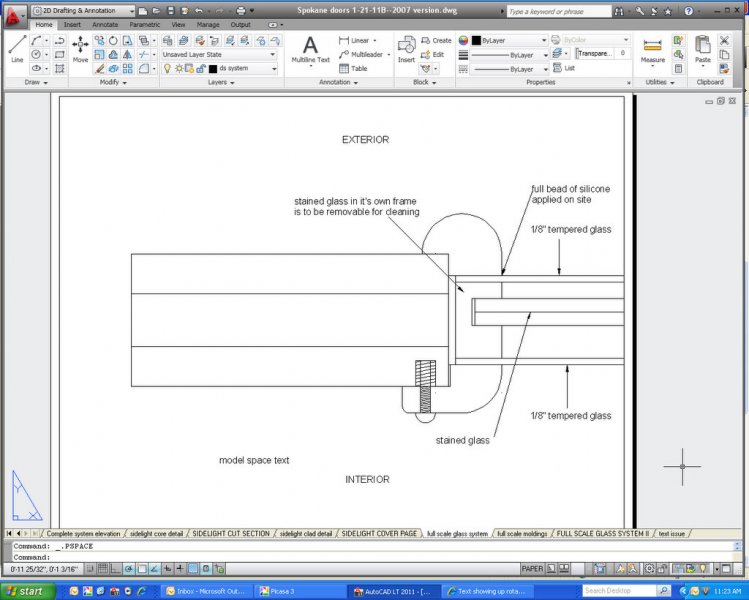

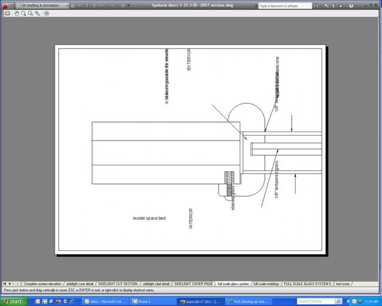

Timothyl Posted February 1, 2011 Posted February 1, 2011 (edited) Greetings, I'm having an issue on my full scale detail sections for a set of entry doors. I used layoutwizard to create my layout and I'm adding text (dtext) and leaders and it all looks good on my screen. When I print it out the text is rotated 90 degrees. I imagine it's any easy fix but I sure can't find it. Any help would be much appreciated! Thanks, Tim I thought I should add- when I look at 'print preview' the text is rotated. When I go back to the layout the text looks correct. I tried unchecking the "match text orientation to layout" and checking it again and it didn't help. Seems like this might be a glitch of some sort? update: If the text is in model space it prints properly. Only the text in paper space shows up rotated. Edited February 1, 2011 by Timothyl Quote

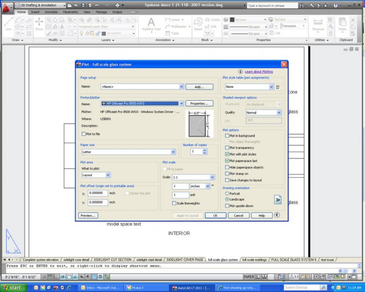

SLW210 Posted February 1, 2011 Posted February 1, 2011 A screenshot or portion of the drawing might help and a screenshot of your plot settings, also. Quote
Timothyl Posted February 1, 2011 Author Posted February 1, 2011 A screenshot or portion of the drawing might help and a screenshot of your plot settings, also. Here are some screenshots. Thanks! Quote

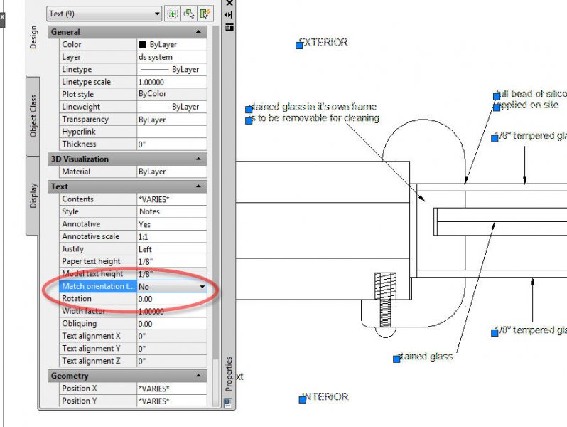

Timothyl Posted February 2, 2011 Author Posted February 2, 2011 I tried toggling "annotative" off and back on but it made no difference. Quote

fahim108 Posted February 2, 2011 Posted February 2, 2011 In the Text Style window, make sure the "Match text orientation to layout" option is unchecked for all the listed text styles. Quote
Timothyl Posted February 2, 2011 Author Posted February 2, 2011 I did that and it made no difference. Quote

Murph_map Posted February 7, 2011 Posted February 7, 2011 Use Qselect and select all text (pspace) then change the text orientation in the property palette. Worked for me. Quote
Murph_map Posted February 7, 2011 Posted February 7, 2011 Thanks Murph, that works! Tim No problem. Glad to help. Quote
