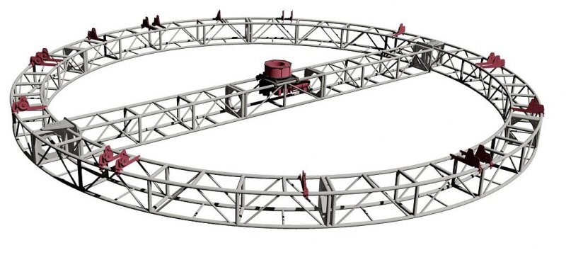

This may very well be impossible, but I thought I'd ask. I have a 3D block of a piece of box truss. And I need it to curve! Without rebuilding the whole block, is there a way to, say, bend it?

There may be a better way, but what I would suggest is that you take the shape as if you were looking at the end of your box truss, put that at the end of an arc or ellipse or what ever shape you need and sweep it using the arc as a path.
Unfortunately, that won't work. There are integral supports that can't be swept or extruded like that. We're using that method for a basic shape right now, but I was hoping I'd find a better way.
http://www.tomcatglobal.com/truss.html
That's what I'm trying to bend.
I've drawn more Tomcat/Thomas style truss than I care to admit in public. It does need redrawn, and it's a pain in the ass. Keep in mind that the truss diagonals only exist in one plane, which further adds to the PITA factor.
The easiest way to get started is to just draw lines (or arcs) for the 2" tube and for the 1" internals (create a skeleton bascially). Then offset and add your welding spaces. After that you can extrude the main truss circles (trim as needed) and start aligning the internal tube solids to the skeleton frame.
Maybe we should put a "warp" or "bend" command for Autocad on Autodesk's "wish list". I thought you were just needing a shape to represent it. I guess you could sweep the outline, shell it, then go through and poke triangular holes in it and chamfer/fillet the bits in the web that are left. That would give you a convincing cartoon. If you are doing some sort of structual analysis on it though it might not work.
Maybe we should put a "warp" or "bend" command for Autocad on Autodesk's "wish list"...
There is a Bend Part command in Autodesk Inventor - but I think I would use Inventor's Frame Generator for something like this.

Ok, got to playing around with that shape, and couldn't stop. I don't know nuthin bout these trusses, and to anybody that does, it probably shows. Had fun doodling with it anyway.
Took no information from the link to Tomcat, just made some stuff up tp see what it would look like. Ok truth is, wife is out shopping with a friend, and sadly I had nothing better to do.

I'd like to have it as well. Maybe some day. The cartoon above is just plain old autocad.
This is a few years old now.. but circular truss. Honestly the truss goes fast once you work out the points and spacing.
That's pretty cool. I realized after I got my cartoon finished that I'd gotten so caught up in making the diagonals that I put them in both planes. Didn't realize it till I was doing the curved bit. By then it was too late to go back and change it. If it had been for something real, sure, but for just playing around, naw...
I don't ever get to play around with stuff like this. I'm usually detailing curtain wall or doors and windows or stuff like that. Sometimes I get to draw some tooling for tubing fabrication. That circular truss looks like fun.
