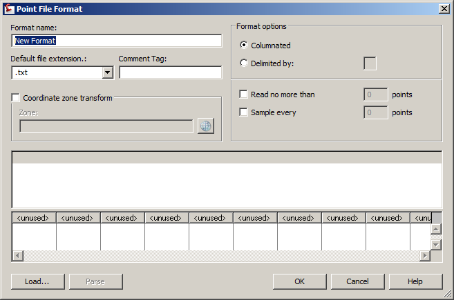

alanjt Posted February 23, 2011 Share Posted February 23, 2011 FYI, if you create a new format for importing points, you can use columnated and it will accept tab delimited files. Quote Link to comment Share on other sites More sharing options...
