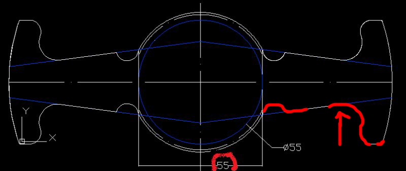

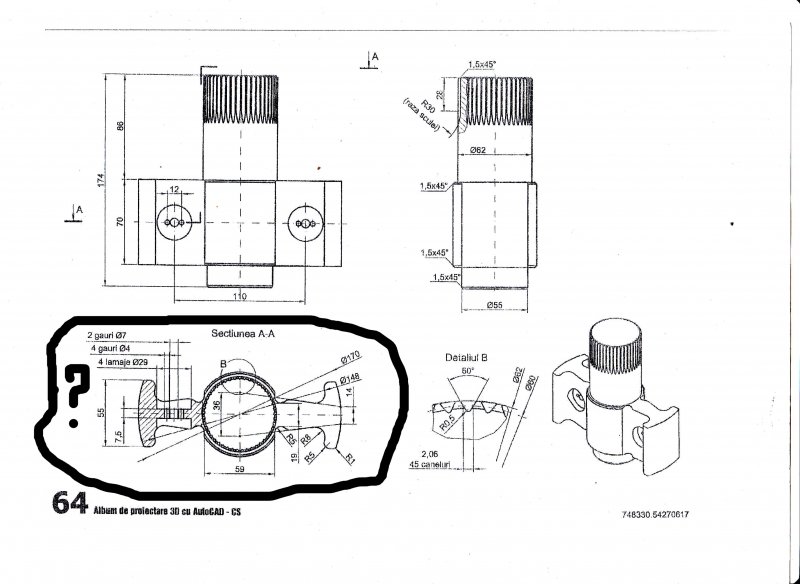

Hello there i need help with a 2d drawing ,
here's the picture of what i want to draw . ( i dont know how to do that arcs.. )

.... i am not so noob , but i cant fit that arcs to the required dimensions....i did try with circles and then trim...and with arc

Your part is not trimmed correctly resulting in incorrect dimension for the 14mm.

huh? ok.....i forgot to trim that ....but is not that the problem....

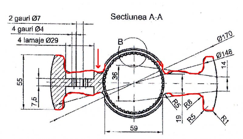

what i cant draw...is this ( what i paint with red )

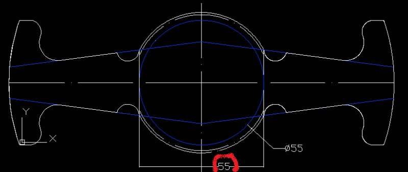

There is a obvious mistake in the drawing.
The 59 dimension cannot possibly be 59 and also be tangent (by appearance) to the Ø55 shaft.
Assume it is actually 55 and all is well (see attached image).
Also note that it appears that the splines (but not sure from your image) were incorrectly shown on the smaller diameter in the end view.
one more question...how you did this arcs? Mistake2.jpg (red painted ) what command did you use ? i cant fit it...or better if you can attach the dwg file.... and yeah is not first time when we get wrong drawings... thanks
The R8, 5 and 1 are simply Fillets.
The R5 is tangent tangent radius. Offset the 55/2 from vertical center. Offset the 19/2 from horizontal center. Then circle ttr to the two offset lines. Trim it up.
