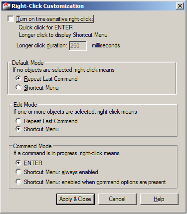

I am not 100% shure what you mean but maybe you want to customize your right mouse button to act as the key.
If so then please follow these steps:
- Type in the commandline: options +
- Go to the tab "user preferences"
- Click on the "right click customisation" button on the upper left
Now you have got some options to check or uncheck...
In my case, where the right click is as you want it to be:
- 1st item = not checked
- 2nd item = set to "repeat"
- 3rd item = set to "shortcut"
- 4th item = set to "enter"
That's about is, try and tell us if it is what you need.
Btw: maybe it's a little different on your PC since I use AutoCAD 2011...

I like to use the time sensitive right click myself. I am curious why you seem so interested in using an extra mouse button for something that you can already do, just as quickly, with another mouse button?
It seems rather inefficient. Is there no other function that you might like to have available on your mouse, without sacrificing the ability to use your mouse for ENTER? Snap on/off, Ortho on/off or something like that?
I hate to take my hand off the mouse, so I can understand your desire to make it more powerful or efficient.
