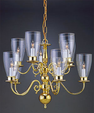

bernardino Posted October 1, 2008 Author Posted October 1, 2008 How do i make this kind of chandelier? Quote
ReMark Posted October 1, 2008 Posted October 1, 2008 Do you know what the different parts of a chandelier are called? The canopy or collar (at the top) could be made using the revolve command. The scrolls and arms could be made using the extrude command. The bobeches can be made with the revolve command and the same goes for the shades. The prisms and pendalogues I'll have to think on. I think I'll have to take a closer look at the image. It's kind of small for me to see all the detail at the moment. Quote
ReMark Posted October 1, 2008 Posted October 1, 2008 The prisms and pendalogues can be made using extrude (for some of the prisms) and loft. Looking forward to seeing your first drawing of a 3D chandelier. Quote
shift1313 Posted October 1, 2008 Posted October 1, 2008 remark, the prisms can be made also with an extrude/taper command i think. assuming you have the taper about correct, them mirror. for the scrolls and arm i wold probably do something a bit different than remark. I would draw the profile of these arms and revolve it 1-3 degrees. then array. Since you are only revolving a few degrees you would not notice any surface concavity. since you are using 2008, you could draw several cross sections and loft between them as well. can you find any larger images? Quote
bernardino Posted October 2, 2008 Author Posted October 2, 2008 remark, the prisms can be made also with an extrude/taper command i think. assuming you have the taper about correct, them mirror. for the scrolls and arm i wold probably do something a bit different than remark. I would draw the profile of these arms and revolve it 1-3 degrees. then array. Since you are only revolving a few degrees you would not notice any surface concavity. since you are using 2008, you could draw several cross sections and loft between them as well. can you find any larger images? I find a larger image of a colonial chandelier but it's different to the other image i send yesterday. Quote
shift1313 Posted October 2, 2008 Posted October 2, 2008 I would start by drawing the profile of the center section. Imagine you gut it into 4 section vertically(like opening an orange). Once you have a closed polyline "section" of the center part you can revolve it. I dont have time right now but tomorrow i can draw a few things to show you how to get started if someone else doesnt chime in. Quote
ReMark Posted October 2, 2008 Posted October 2, 2008 That's more of a contemporary colonial compared to the first image you posted. I agree with shift. Create a profile of the center section and revolve it. With the exception of the arms and the chain it looks like you could use the revolve command for the majority of the chandelier. For the arms I would consider drawing the centerline then extruding a circle along this path. That will get you well on your way. For information regarding the names of the parts of a chandelier go to www.chandelierparts.com. Quote
