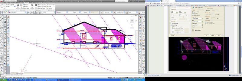

SLW210 Posted March 23, 2011 Posted March 23, 2011 Have you got something like this? If it isn't too much trouble, would you mind answering a few questions? Check your hatch settings and see if island detection is set improperly How are you selecting your Hatch area? Quote

SLW210 Posted March 23, 2011 Posted March 23, 2011 I had no problems Hatching with pick points or Select object. Pay attention to my settings and compare yours. As an after thought, try selecting the Hatch Origin, I picked the Center of the Circle. Quote
burnsiecanuck Posted March 23, 2011 Author Posted March 23, 2011 Try and hatch in the layout labelled "working" see attached image Quote
nestly Posted March 23, 2011 Posted March 23, 2011 Wierd. I see what you're seeing. I can hatch normally in the model tab, but I can only hatch the entire circle in the MS viewport, and even then, hatch preview doesn't work. It seems to have something to do with the view, because when I rolled the house upside down with the compass, I can hatch either side of the circle ( although hatch preview still didn't work) Here's a demo http://screencast.com/t/B9hUMVaZXiVo Quote
nestly Posted March 23, 2011 Posted March 23, 2011 Scratch that, Hatch and hatch preview work normally when the UCS is set to World. Now why is your house upside down? Is it in the southern hemisphere Quote
