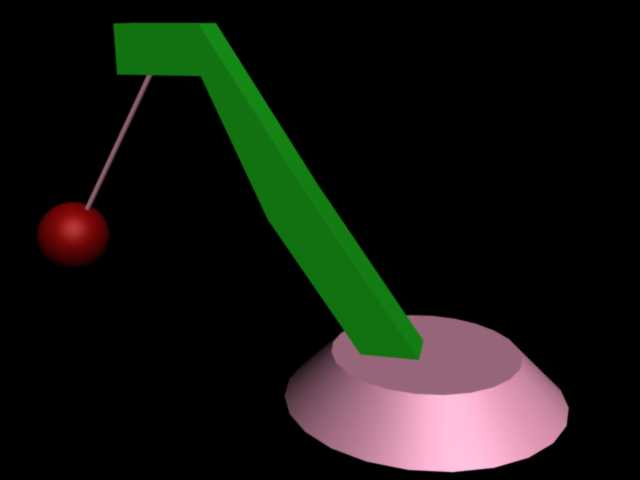

joeburns Posted March 29, 2011 Posted March 29, 2011 I'm trying to create a pulley system and am having 2 issues: I'm successful connecting my rope to a crane or pole at one end. When I try to connect to something on the other end, I get an error that I can't create a circular reference. To my knowledge, I'm not trying to create one. I'm following the directions from a tutorial that, unfortunately, was created under an old version of 3DS Max. However, that being said, I'm selecting the vertices that are inside my sphere at the end of the rope. When I try to assign them to the rigid body, I get the error message. I have a block & tackle system. The top and bottom both have 2 pulleys. My rope weaves through the two pulley systems and is connected to a rigid body at the end of the rope. I want to pull the other end of the rope and have the bottom block slide up the ropes toward the top. How do I have the rope slide through the pulleys and make the pulleys come together (the top is fixed to the ceiling). Thank you, Joe Burns Quote

joeburns Posted March 30, 2011 Author Posted March 30, 2011 Here's the link: http://www.3dk.org/tutorial/3ds-max-Combining-Reactor-Rope-Keyframe-Animation.html Here's the JPG rendered frame. Hopefully it comes out OK for you. Quote

joeburns Posted April 4, 2011 Author Posted April 4, 2011 I thought I had replied to this. I guess not. I am on 2011. The "15 times" may be a slight exaggeration, but I have done the steps multiple times - from the top and with any possible changes that I could think of. Attach and expand the "Reactor Rope" modifier. Choose "vertex" and select the verticies that are within the object that you want to constrain the rope to - in this case, the 2 to 4 verticies that are within the ball. Scroll down to the "Constraints" rollout and click on "Attach to Rigid Body". This will put the "Attach To RigidBody" constraint into the list. Click that and you'll see a rollout above the "Constraints" one titled "Attach To RigidBody". Click the button in there and choose the rigid body object to constrain the verticies to. When I do these steps to attach the rope to the crane, everything is fine. When I do this to attach the rope to the ball, I get my circular reference error. Quote

joeburns Posted April 21, 2011 Author Posted April 21, 2011 I guess that I should have posted that I figured this out. Now I've progressed to the next step. I have the wrecking ball working perfectly. I believe that I had to remove the constraints on the objects that are outside of the reactor controls. Te ball now swings perfectly as the crane swings. I'll start another thread with my new issue - a block & tackle where the control pulley pulls on the cable which raises the lower part of the b&t to raise up to the top block. This is how cranes at docks work. The lower block would be attached to the object to be lifted. As teh pulley cranks, the object is raised off the ground. Quote
