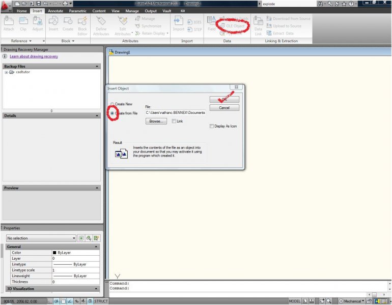

CAnnondale Posted April 14, 2011 Share Posted April 14, 2011 Hi nchaplin, Sorry for the delay busy with work. 1. Launch AutoCAD>Insert>Data panel>OLE Object>Insert Object from file>Select the *.eps 2. When it is already opened, invoke EXPLODE and select all the entity Why? The *.eps was converted into "BLOCKS" and you need to edit in order you can Insert it in INVENTOR. 3. Save the DWG 4. Once you are done then, Launch INVENTOR 5. While in SKETCH mode>Insert>ACAD (insert the saved file) Hope this will help you. Quote Link to comment Share on other sites More sharing options...

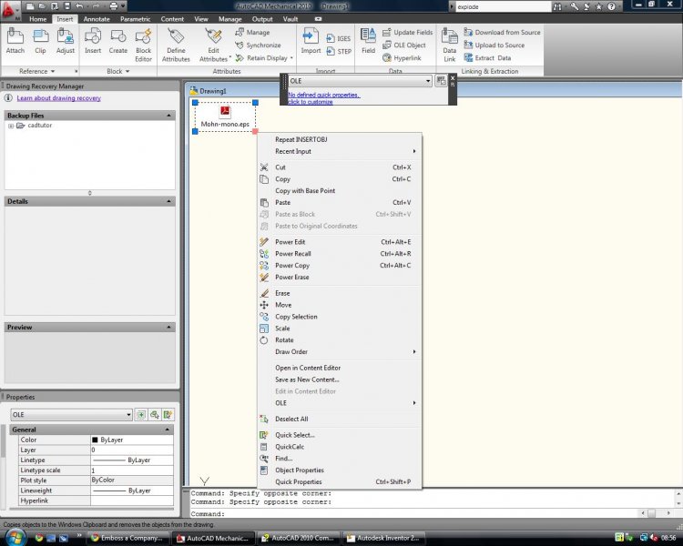

nchaplin Posted April 14, 2011 Author Share Posted April 14, 2011 Hi nchaplin, Sorry for the delay busy with work. 1. Launch AutoCAD>Insert>Data panel>OLE Object>Insert Object from file>Select the *.eps 2. When it is already opened, invoke EXPLODE and select all the entity Why? The *.eps was converted into "BLOCKS" and you need to edit in order you can Insert it in INVENTOR. 3. Save the DWG 4. Once you are done then, Launch INVENTOR 5. While in SKETCH mode>Insert>ACAD (insert the saved file) Hope this will help you. Hi Willie, Firstly I only Have Auto CAD Mechanical will this cause a problem ? I think I got to the stage of EXPLODE but couldn't find this operation. attached a couple of pic's to show you what I did. I typed EXPLODE into the command bar but with no luck it just gave me a box of 4 lines. thanks for your help Nathan Quote Link to comment Share on other sites More sharing options...
SLW210 Posted April 14, 2011 Share Posted April 14, 2011 I thought Mechanical came with Vanilla AutoCAD? Quote Link to comment Share on other sites More sharing options...
dshowalt Posted April 14, 2011 Share Posted April 14, 2011 Try typing EXPLODE before selevting the object. Otherwise use the F1 key to lookup EXOLODE procedure. Quote Link to comment Share on other sites More sharing options...
JD Mather Posted April 14, 2011 Share Posted April 14, 2011 Firstly I only Have Auto CAD Mechanical.... No, you have both as Mechanical runs on top of vanilla. Instead of using the desktop icon to start - - go to Start>All Programs>Autodesk>AutoCAD Mechanical>Run as AutoCAD. You can right click-drag a start icon out the desktop if desire. Quote Link to comment Share on other sites More sharing options...
