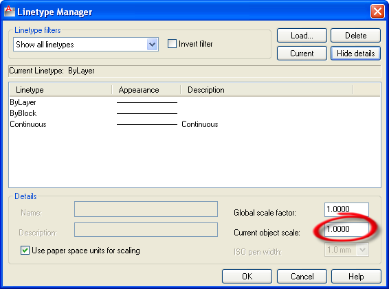

Ahankhah Posted April 19, 2011 Share Posted April 19, 2011 You can also change the linetype scale of current object. Simply: 1- Issue "LT" command, or select "Other..." from Linetype combobox in toolbar menu. 2- Select "Show details" from the dialog box. 3- Change the value in Current object scale edit box as desired, then press OK. Quote Link to comment Share on other sites More sharing options...
