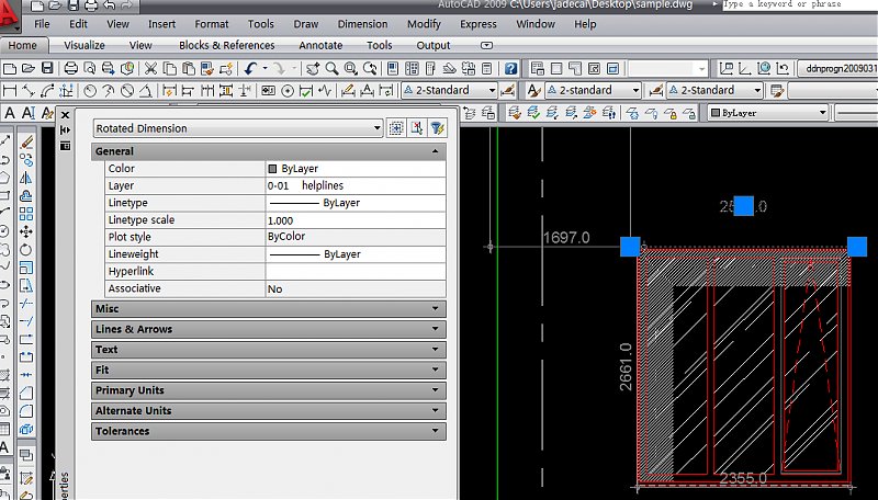

ichlove
Hi Lee Mac,
Thanks for the lisp,but the properites of the dimension is not associate.we really need assiciate.One more request,is that possible to choose several objects/blocks to make dims at the same time and make the dims text have specific distance from the objects?see the attached smaple.
thanks in advance
sample.dwg

ichlove
Sorry ,still not associative:(,see the attachment.
Can I have the distance dialog everytime ,so that I can decide different ditance for different situation.
Thanks
Maybe this?
(defun c:dimobj     (/ ss vlst ovar obj minpt maxpt crds)
 (if (setq ss (ssget))
     (setq vlst '("CMDECHO" "OSMODE" "DIMASSOC")
       ovar (mapcar 'getvar vlst))
     (mapcar 'setvar vlst '(0 0 2))
     (foreach obj  (mapcar 'vlax-ename->vla-object
               (vl-remove-if 'listp (mapcar 'cadr (ssnamex ss))))
   (vla-getboundingbox obj 'minpt 'maxpt)
   (setq crds (mapcar 'vlax-safearray->list (list minpt maxpt)))
   (command "_dimlinear" (car crds)
        (polar (car crds) (/ pi 2) (- (cadadr crds) (cadar crds)))
        (polar (car crds) pi (* 2 (getvar "DIMTXT"))))
        (polar (car crds) 0 (- (caadr crds) (caar crds)))
        (polar (car crds) (/ (* 3 pi) 2) (* 2 (getvar "DIMTXT")))))
     (mapcar 'setvar vlst ovar))
   (princ "\n<!> No Object Selected <!>"))
 (princ))
What offset would you like? A prompt for an offset?
Share this post
Link to post
Lee Mac
This will include a prompt for offset distance - I can't work out the dimension associativity though... I've set the DIMASSOC to 2, and even when I have finished the LISP and try to dimension myself manually, the dims are associative, so not sure whats going on here...
(defun c:dimobj     (/ ss off vlst ovar obj minpt maxpt crds)
 (if (and (setq ss (ssget))
      (not (initget 7))
      (setq off (getdist "\nSpecify Offset Distance: ")))
        (polar (car crds) pi off))
        (polar (car crds) (/ (* 3 pi) 2) off)))
 (princ))
Share this post
Link to post
ichlove
Anyway,thanks Lee Mac:)
