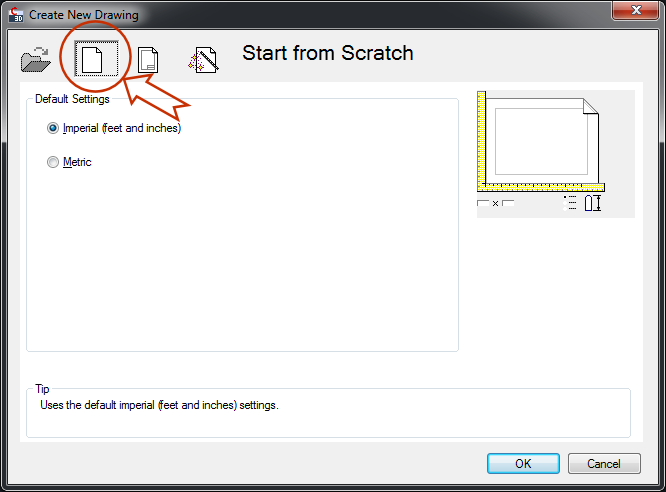

You could always go to Big Red C -> New -> Drawing, and select "Start from Scratch" along the top.

ps - almost fell for "start from scratch" - I like the hazing!
