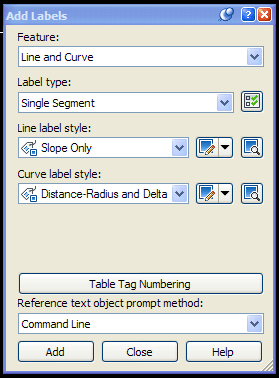

Diast Posted May 2, 2011 Posted May 2, 2011 Under the Annotate Tab / add labels / line & curves / add line & curve labels a window normally pops up asking for info. One of my techs has lost this on her computer and we can't figure out what happened. Checked the options and hers is the same as mine. Not sure what she did. Any suggestions ? Thanks, Quote

Diast Posted May 3, 2011 Author Posted May 3, 2011 Sorry I didn't add pertinent info. Windows xp AutoCad 2010 c3d. Tried the add feature command with no luck. Overnight rest and restart; no help. Don't know how to add screen shot to this forum. Quote
Diast Posted May 3, 2011 Author Posted May 3, 2011 Don't know if this worked or not. Tried to Attach image. Quote
BlackBox Posted May 3, 2011 Posted May 3, 2011 Sorry I didn't add pertinent info. Windows xp AutoCad 2010 c3d. No worries. Tried the add feature command with no luck. Overnight rest and restart; no help. Manually issuing the command does the same thing as hitting the ribbon panel button. Don't know how to add screen shot to this forum. Use 'Manage Attachments' button when making a post... you may need to first hit the 'Go Advanced' button. Quote

BlackBox Posted May 3, 2011 Posted May 3, 2011 Yes, that is an image of the resultant (missing) dialog. Quote
