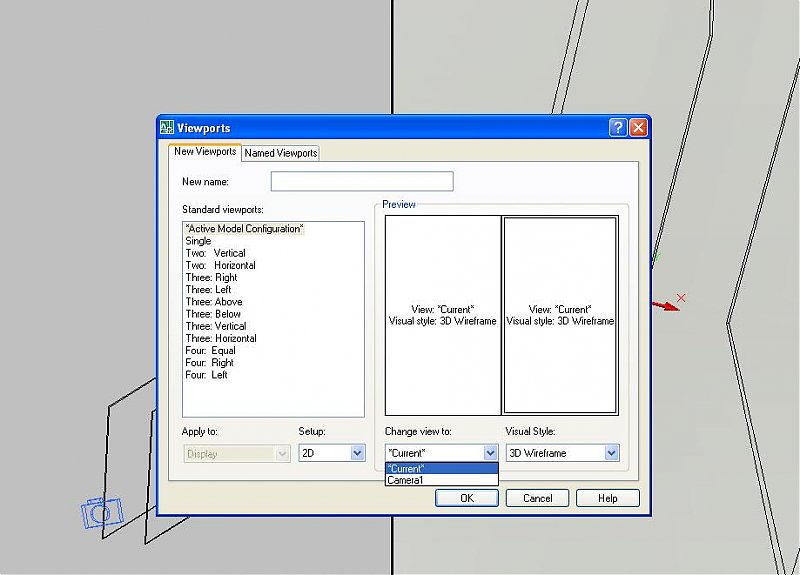

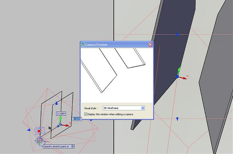

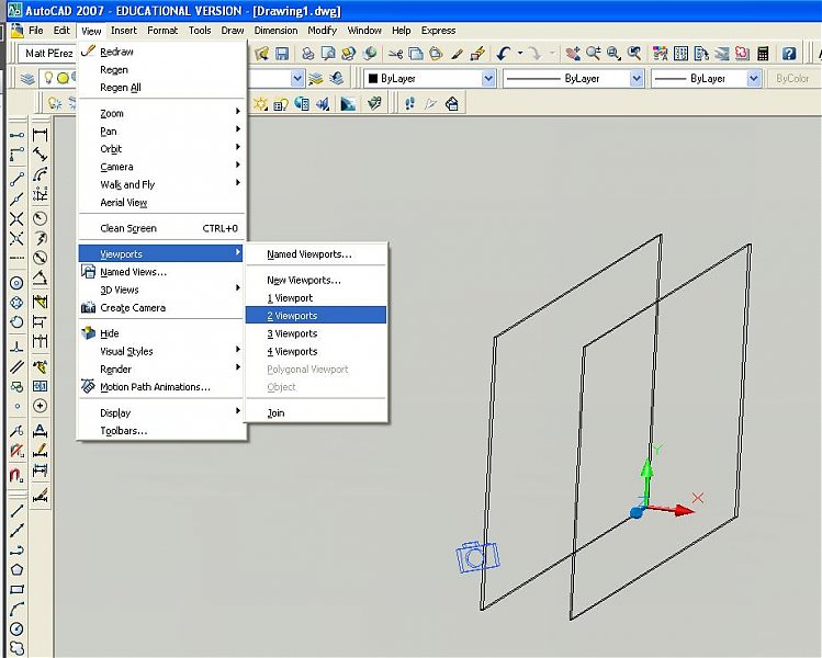

shift1313 Posted October 2, 2008 Share Posted October 2, 2008 here are a few screen shots for you from acad 07. I created a camera located between the two walls. went to the viewport manager under the Named Viewports in your View menu and set it up so i had two vertical windows, one was *current*, the other is set to camera. Then when you right click on the camera you can set up the preview screen. When you select the camera to move it, you will see the changes in the preview screen before you hit enter. Then to get a nice view you can render your camera view. I did this quick so i probably left something out. let me know if this helps or if you have any questions. Quote Link to comment Share on other sites More sharing options...

shift1313 Posted October 6, 2008 Share Posted October 6, 2008 you just have to play around with it. Make sure you use a camera and have the camera preview window. You will get it after you play around a bit. There isnt anyway for us to say this zoom or this position works for you. If everything is drawn to scale you can orient your ucs at a certain point and give your camera coordinates that would be accurate for your height(eyes). Quote Link to comment Share on other sites More sharing options...
