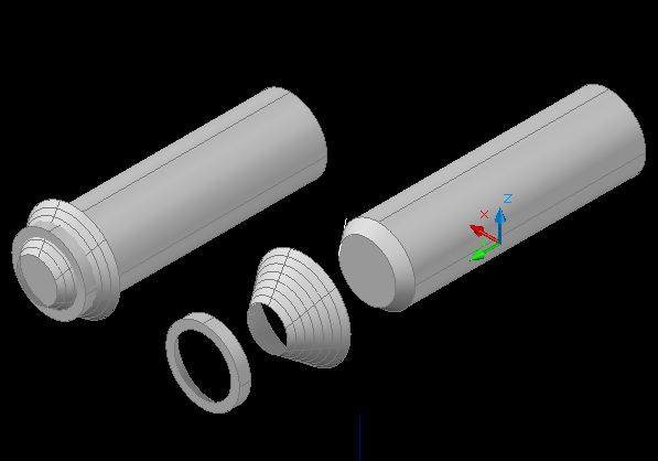

Has anyone had success using AutoCAD's CHAMFER>ANGLE command to chamfer in 3D? Distance/Distance works fine, but I haven't yet figured out how to use the chamfer tool to put a 30 degree chamfer on a cylinder (or any angle for that matter) by specifying a distance and an angle. Seems like it should be simple, but I always give up and end up creating the tapered edge by revolving a polyline that already has the chamfer, or using the TAPER>FACES tool.

My inputs for the cylinder shown below.
Command:
CHAMFER
(TRIM mode) Current chamfer Length = 0.2500, Angle = 45
Select first line or [undo/Polyline/Distance/Angle/Trim/mEthod/Multiple]:
Base surface selection...
Enter surface selection option [Next/OK (current)] :
Specify base surface chamfer distance :
Specify other surface chamfer distance :
Select an edge or [Loop]: Select an edge or [Loop]:
Yeah, 45 degrees works for me too because AutoCAD seems to ignore the ANGLE option and defaults into Distance/Distance mode resulting in a 45 chamfer. Can you make a 30 degree chamfer using CHAMFER and specifying an angle?
Can I? Yes, but not without first knowing the distances which to me doesn't make a whole lot of sense. If I know one of the two and the angle then AutoCAD should be able to do it. I must not be using the command correctly. Maybe the Angle option only works for 2D objects?

I just found another related thread here, and a tutorial by Matt Murphy which seem to confirm that AutoCAD can't do that simple procedure in 3D, which is pretty lame.

At 1 minute, he says "When you chamfer a solid, there is no angle option"

Found this issue a few minutes ago and found that by entering the first distance (in my case .5) and then using the Expression command for the second distance, I could input:
Tan(60)*.5
This produced a 60 degree chamfer. Long winded and unnecessary, but functional.
Command: _chamfer
(TRIM mode) Current chamfer Length = 0.5000, Angle = 20
Enter surface selection option [Next/OK (current)] <OK>:
Specify base surface chamfer distance or [Expression]: .5
Specify other surface chamfer distance or [Expression] <0.5000>: e
Enter expression: Tan(60)*.5
