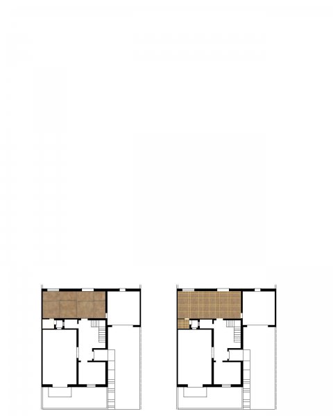

Polly64 Posted June 1, 2011 Author Posted June 1, 2011 ReMark, I've attached the drawing as a jpeg....its the first time I've done this so I'm not sure I've done it right! I'm sorry if it came out abit small but I hope you'll manage to get the general idea. If I have done it right....you'll see that in the first drawing, the material insert is too large for the room size. In the second drawing, I divided the room into squares and inserted the material into each square. it looks abit better but the dividing lines still show and they can't be removed without deleting the whole thing. My only solution was to change the line colour to match the materials. Thanks once again for your help....I really appreciate you taking time over this..... Quote
ReMark Posted June 1, 2011 Posted June 1, 2011 What if you put the grid and the material images on their own separate layers then after inserting the image in each square you froze the grid layer? Quote
Polly64 Posted June 1, 2011 Author Posted June 1, 2011 That might work....let me try it. Don't know why I didn't think of that myself!! Duh! Quote
ReMark Posted June 1, 2011 Posted June 1, 2011 Unless your image has a high resolution to begin with you may begin to notice distortion when resizing it. Quote
Polly64 Posted June 1, 2011 Author Posted June 1, 2011 Ok....this is just weird. I put the grid and the materials on two separate layers and it looked ok til I froze the grid layer....and got double grids! Quote
ReMark Posted June 1, 2011 Posted June 1, 2011 Did you copy over your grid to the image layer without realizing it? Quote
Polly64 Posted June 1, 2011 Author Posted June 1, 2011 don't think so. I just tried changing the colour of the grid lines....and they've disappeared altogether now....or rather just blended in. So maybe I've temporarily solved the problem?? Quote
nextvkin Posted June 23, 2011 Posted June 23, 2011 Hi, You can make regions & apply materials (RMAT) to them, and then set the shademode to realistic. Quote
