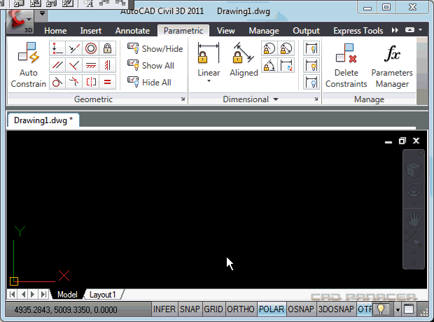

rkmcswain Posted June 2, 2011 Share Posted June 2, 2011 I have drawn a rectangle, using the rectangle command. Now I want to enlarge it only in one edge. I wanted to use those small squares (Don't remember their name), however I find out that there is no middle square to move one edge. After you draw the rectangle, add auto constraints to it (command: _AutoConstrain) and then when you stretch a corner grip, it will maintain its shape. Quote Link to comment Share on other sites More sharing options...
khoshravan Posted June 2, 2011 Author Share Posted June 2, 2011 Stretch command. Or use Hot Grips by holding shift and select the two grips. The will turn red.Autocad 2011 has the midpoint grip for polylines including rectangles. It is a nice addition. Using hot Grips by shift key was a nice method. thanks I use ACAD2011 and am looking for the solution you mentioned but middle hot grip is not present. Only 4 hot grips in 4 corner is visible. Quote Link to comment Share on other sites More sharing options...
khoshravan Posted June 2, 2011 Author Share Posted June 2, 2011 After you draw the rectangle, add auto constraints to it (command: _AutoConstrain) and then when you stretch a corner grip, it will maintain its shape. [ATTACH]27978[/ATTACH] Thanks. This is a nice solution too. btw how do do you make that animation and upload it? Quote Link to comment Share on other sites More sharing options...
