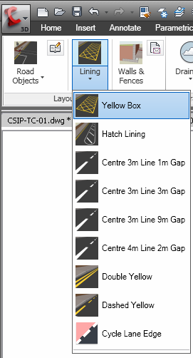

I have been looking at how to extra icons for AutoCAD ribbon tabs and panels I have created for our office. I downloaded a few sets of icons from the web but they didn't work our very well.
I then hit on the idea of using Sketchup to create icons. I created a model of the item I wanted to show like this.
And then used Paint.Net to resize and save it as bmp.
This what I have for icons in CAD then.
Just thought I'd share it.

Ahankhah
Nice one but very difficult to guys like me!

Organic
They look good. My custom icons are all 1 minute jobs done with the built in AutoCad icon editor lol.

SunnyTurtle
Just wow that would make autocad a lot more user friendly that Autocad Icon editor is so restrictive and i just end up with letters

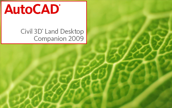

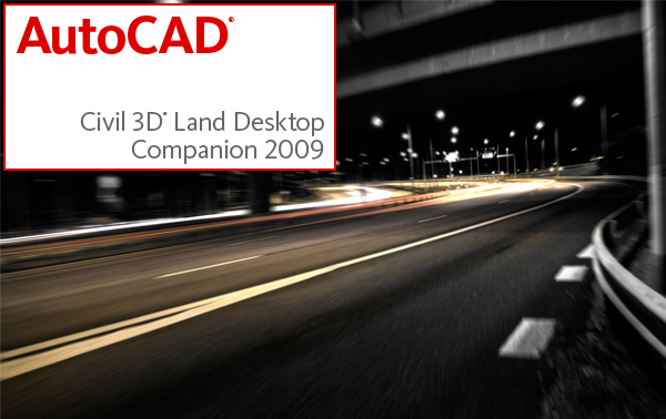

BlackBox
Very neat tip! :)
Haven't tried paint.net yet, I've always used Photoshop, or the built in icon editor... just made some custom, discipline splash images today for some folks in other groups (environmental, and transportation respectively):

woodman78
I have used Photoshop mainly too but gave Paint.net a try and really liked it for light stuff.
