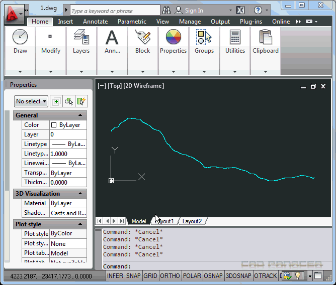

nestly Posted June 10, 2011 Posted June 10, 2011 In most cases I would say these very large polylines are from C3D and Map. Here's an example. The drawing contains only one object; a polyline. With the Properties palette open, it takes 79 seconds from the time I select the polyline until AutoCAD finishes calculating. See if you can beat my time. 1.dwg Quote

rkent Posted June 20, 2011 Posted June 20, 2011 In most cases I would say these very large polylines are from C3D and Map. Here's an example. The drawing contains only one object; a polyline. With the Properties palette open, it takes 79 seconds from the time I select the polyline until AutoCAD finishes calculating. See if you can beat my time. Less than 3 seconds here. Quote

rkmcswain Posted June 21, 2011 Posted June 21, 2011 With the Properties palette open, it takes 79 seconds from the time I select the polyline until AutoCAD finishes calculating. See if you can beat my time. With Properties open, it took 56 seconds. With Properties closed, about 1.5 seconds. Using Civil 3D 2011. Quote

nestly Posted June 23, 2011 Posted June 23, 2011 The slow picking seems to be a little more specific than just having the Properties palette open. It appears to be the "Area" property because I can pick it instantly if the Geometry panel in the properties palette is minimized.... ditto for Quick Properties. If I exclude "Area" from QP, I can pick it pretty much instantly. Quote
SLW210 Posted June 23, 2011 Posted June 23, 2011 The slow picking seems to be a little more specific than just having the Properties palette open. It appears to be the "Area" property because I can pick it instantly if the Geometry panel in the properties palette is minimized.... ditto for Quick Properties. If I exclude "Area" from QP, I can pick it pretty much instantly. You are correct, I have instant select with properties closed or properties open and geometry closed. Still 2 minutes with properties open with Geometry open. (I previously did not completely shut down properties on that test). Kinda seems like the old problem with properties and dimensions if you had Lines and Arrows open. P.S. Just got the Nvidia Quadro 600 installed. Quote
