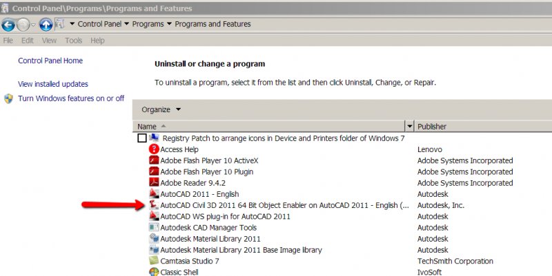

SLW210, Do you have the C3D Object enablers installed for your AutoCAD2011?. I do, but I wonder if they would be Proxy Objects instead of polylines (or spot elevations) without the Object Enabler. If so, then maybe it's not AutoCAD per se, rather a bug in the C3D Enabler for AutoCAD2011.
I have all updates, I was thinking this morning about that and actually wondered if it could be the service packs. But it looks like this problem on Autodesk precedes the service packs.
The files I am using are pretty old and have been AutoCAD files for quite some time. I don't know if that has any bearing on this either.
I was talking about the C3D Object enabler for AutoCAD that allows AutoCAD to edit Aeec objects created in C3D rather than simply displaying them as proxy objects.
http://usa.autodesk.com/adsk/servlet/ps/dl/item?siteID=123112&id=15131158&linkID=9240618
[ATTACH]28324[/ATTACH]
I know what you are referring. I have all of the OE's and updates, service packs etc. I check for new updates every Monday.
