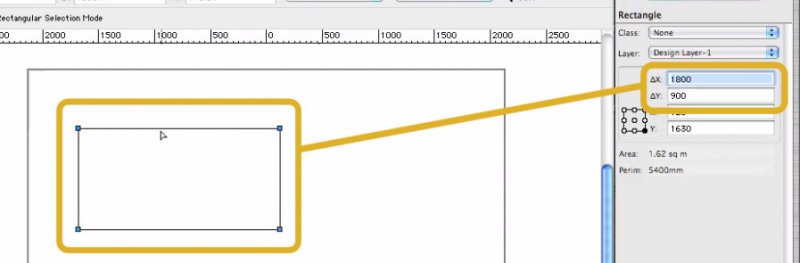

Is there a function in AutoCAD that lets you edit the dimensions of an existing object on fly like there is in Vectorworks.
I have included an attachment of a vectorworks screen dump to help explain what I'm asking. In the screen dump you can see a Rectangle is already drawn with the measurements of 1800,900 mm. This can be changed in Vectorworks via the dimension property box on the right hand side. Can this sort of thing be performed in AutoCAD?

I don't know anything about Vectorworks. Some types of objects can be sized from the Properties Palette, some can't. AutoCAD doesn't have Rectangles per se, only orthogonal polygons, so the answer to your specific example is "no". More recent versions do have Parametric Dimensioning
http://www.youtube.com/watch?v=DJOrX8Jn5sc
